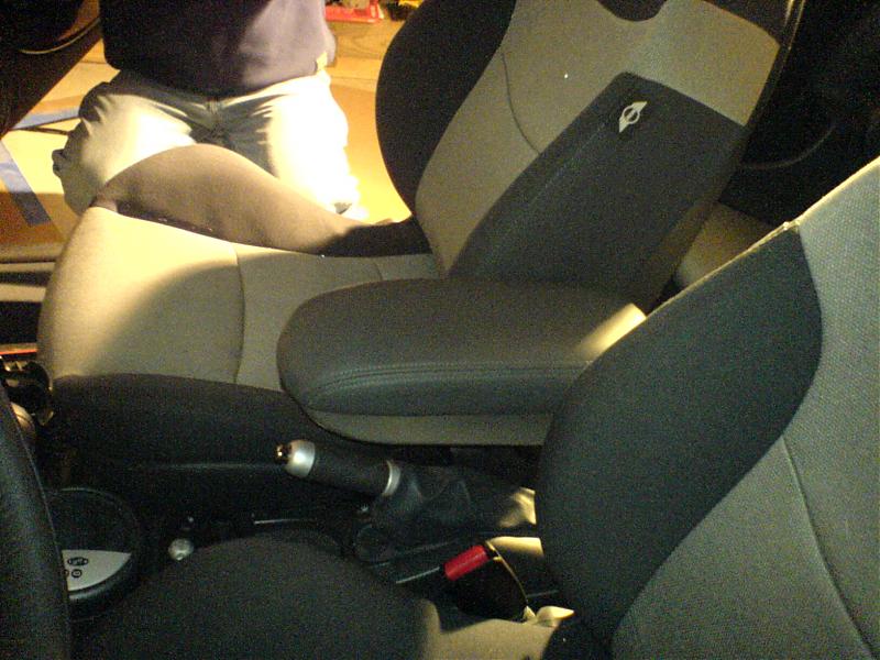

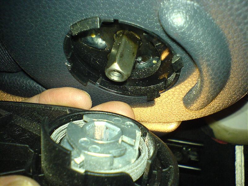

Success!! The installation only took about an hour, and I'm very happy with the results! Your input about the seatback removal was much appreciated Scooterboy, since it is not mentioned in any literature!! We ended up just taking the whole back off for easier access.
Here are some pics: bracket to put in, removal of the seat-adjusters, we found a Knome overseeing our heating elements (for those of you interested what was inside the seat.. he watched to make sure we didn't accidently slice anything since the elements are a spun wire, embedded in some of the foam), a bit of foam had to be removed for the bracket to sit properly, it wasn't mentioned but a portion of the armrest support is unnecesary to fit a MINI's svelte proportions, and the final product installed.
Off for a drive to test it out!

Back from the drive, and Highly recommend this armrest!! This outdoes the factory op because it is so adjustable! Looks like it was a factory fit too!
Here are the other pics that wouldn't fit on the last post....
Happy to give more feedback!
