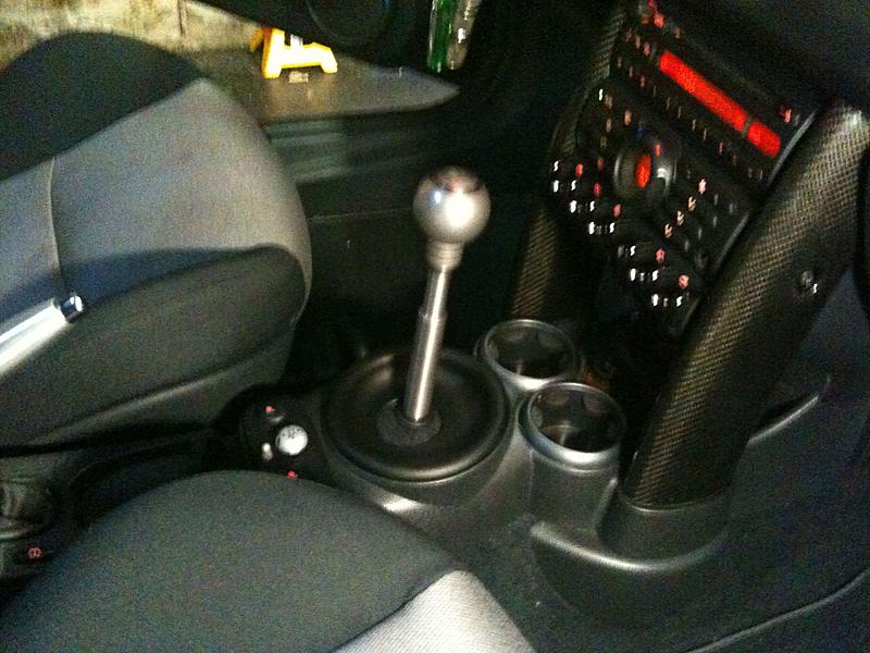

Finally got this finished up. The B&M was hard to find since its now out of production for later R53s. The height is about the same, just a little stiffer with a shorter throw. The weight of the whalen helps you not notice the increase in stiffness.
~sorry for crappy phone pic
