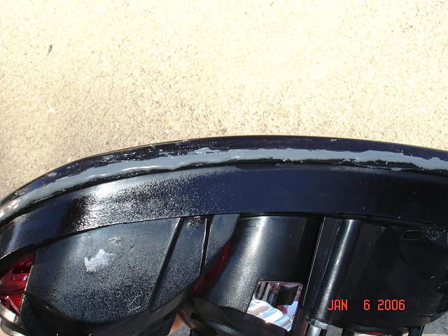

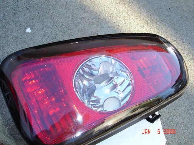

Here they are..
I even cut out the amber lens to see how they looked.. the poor mans version of the clear lens. I used a dremel w/ a cutting disk and carefully cut in between the outer lens and the black plastic housing.
You can pull the red lens out (harder) or mask the red lens and sand down teh chrome and then paint (don't forget to mask the holes on the back of the lights! some paint can get onto the reflector and get you a big headache.)
Let dry and put the clear outer lens on and epoxy it back together. Apply a little epoxy at a time you don't want it to drip into the housing and ruin everything.
(Note: NO forcing it on it will sit on the back housing with a gap because you already cut that portion off).
MCuS

Originally Posted by not-so-rednwhitecooper
I'm still workin on a set of mine that i broke.
Still trying to get them open without using the oven...
Using an oven won't work. I already tried it. The stuff keeping the outer lens on doesn't separate by heat (like the honda stuff). Its almost like epoxy.
