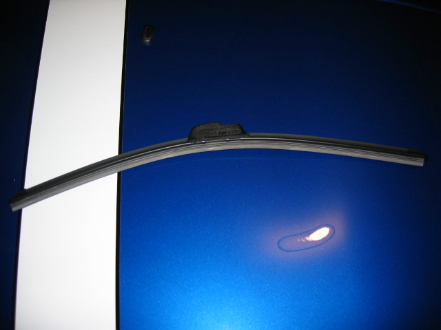

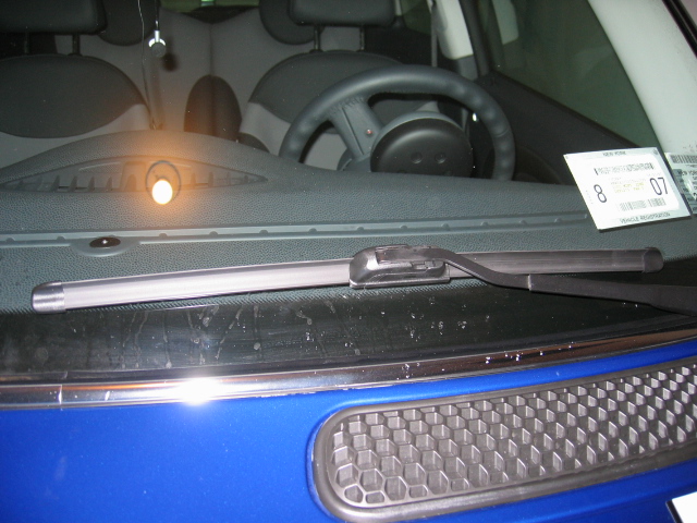

I just picked up a pair today.
I think only Autozone carries them. The book doesn't list the MINI but they do fit. 19" on the passenger side and 18" on the driver's side. The part number is: driver 418A and passenger 419B. The last half inch or so on the passenger side doesn't touch the glass. But it's barely noticeable. You have to look up close to notice it.
You can even send in for a free $15 Autozone Gift card when you purchase two.
Oh yeah, don't bother looking for them on the shelves. Ask the counter person.

Oh yeah. I'm planning to swap back to the stock ones when I take it in for maintanence. Who knows, the dealer may give me new wiper blades.

I tried out a set of these tonight, but I got the "Bosch Icon" ones intead of the others ones. They appear to made exactly the same way. Unfortunately they have a couple issues:
1. Passenger side misses about 1" wide section at the bottom. I could live with this if there were no other issues.
2. Despite them being 18 & 19 inch wipers, they still cover about 1/2" less of the windshield than the factory wipers on my 2006. Again, I could probably live with this but...
3. The drive side aerodynamics are all wrong - the wiper "pulls in" a vortex that spreads water back across the driver side a good 3-4" in heavy rain at higher speeds, making them less effective and blocking out some visibility.
So #3 was the breaker. They annoyed me enough that I could only last about 10 miles before I put the stock wiper assemblies back on. I guess that funky wind fin on the OEM wiper has a purpose after all. Those Mini engineers know what they are doing after all.
yeh, this is why i just get the OE ones.
