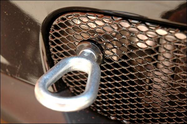

I found this photo. I don't know who's car it is though.

that's my car... thanks
what I did was install the grill and bumper. Go to Home Depot and get some black "Hole Grommets 3/4" inside diameter #74134, Buchanan brand . Go home and cut a small hole in the grill with some clippers, right in line with the tow hook hole. Then go a little bigger until the tow hook goes through. Then cut until the grommet fits... Mine looks perfect as you can see

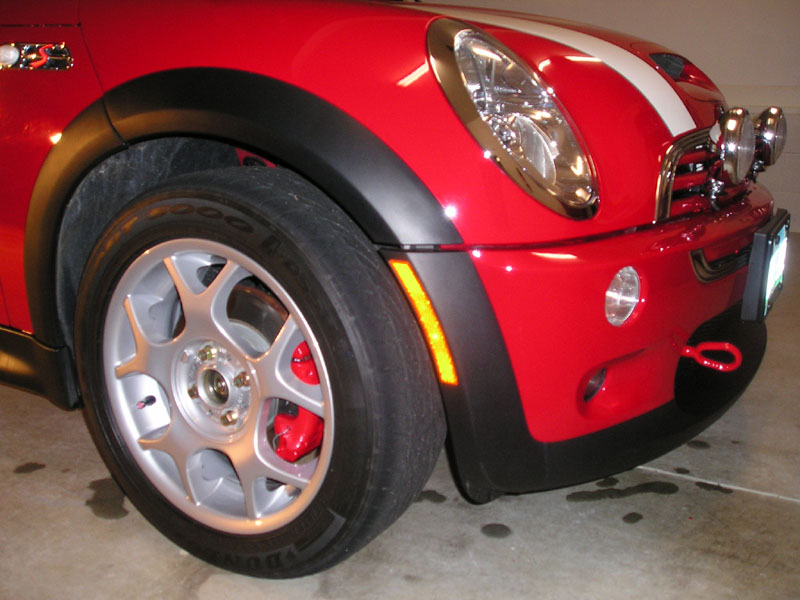

There is two photos I took today of my brake caliper paint job. It show the tow hook. I use the G2 caliper paint on the hook as well. It looks good (I think) but on a HP level maybe 2 or 3 tops!
