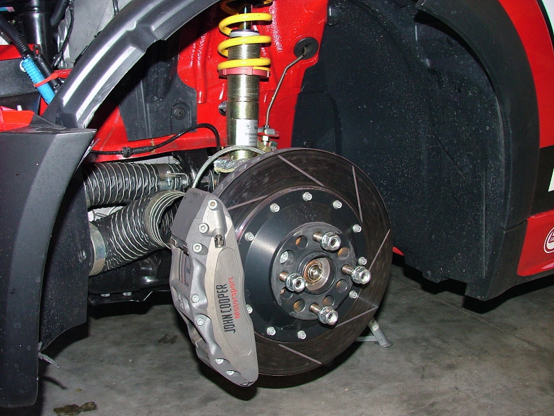

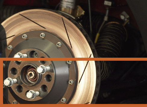

Here are a few pics from the MINI United Spec cars. How can we get some more pic's of the way the duct work is run. For that matter how can we get more pic's of HOW the MINI United Spec cars are prepaired to race!

Has the dust shield been removed from those United MINI Spec cars?
