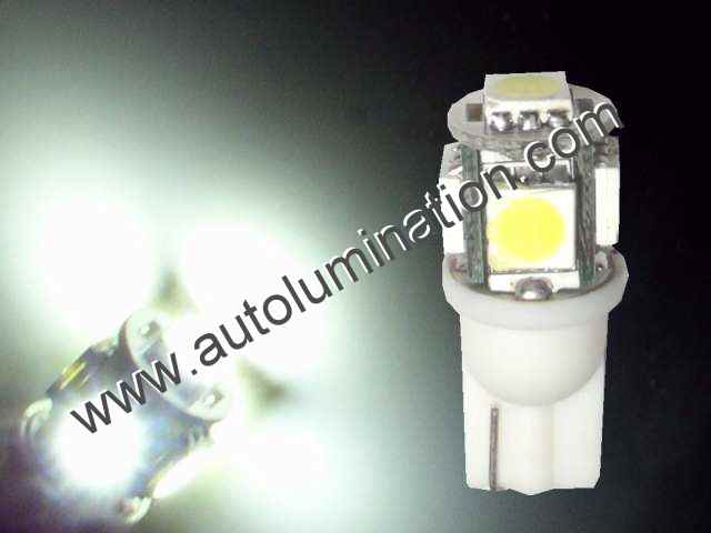

Better (best?) LED parking lamp solution!
I've been running with my plain ole' 5-way white LEDs in the front parking lamps for a couple of months now. I just recently got one of these "high flux" 5 way LEDs from AutoLumination for my cabrio interior dome light - and it was SUPER BRIGHT!
So I ordered two more to try in my front parking lights - they fit with no problems (not too wide like the old 5-ways were) and are REALLY BRIGHT - seem just as bright as the old incandescent bulbs - you can see them fine in the daytime! They're going to be like searchlights at night compared to the old LEDs. Very, Very Happy.
This is a great 3-minute mod for anyone who has gone with xenon-match fogs and high beams...

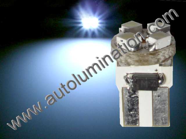

Update: After about 5 weeks, these bulbs were TOAST in my parking lamps - 4 of the 5 elements had failed and the last was flashing.
I just replaced them with these:
which supposedly have better current regulation and heat tolerance - we'll see...

Here's my experience with the 5-way high flux SMT:
At the beginning of the year, I purchased 3 of them -- 1 for my cabrio dome light and 2 for map lights. I hardly ever turn on the map lights. The dome light has only been lasting 2-3 months before one or more of the 5 elements starts to go out or flicker. When that happened, I swapped the dome bulb with one of the map lights, and I have had to do it twice already (thus in 6 months I am already on the third bulb in the dome). My dome light only turns on when getting in and out of the car. Total "on" time in 2 months cannot be much more than several hours, and it already starts to burn out? I love the brightness of this bulb -- far brighter than any other 194 I have tried (and I have tried quite a few); however with such short life it is difficult to recommend.
Ultraleds in the UK sells the same bulb but offers a one-year warranty at about the same price (including overseas shipping) as Autolumination. I may try them if I don't find another 194 bulb with similar brightness.

i actually meant the 4-star smt led bulbs. the 5-way high flux smt ones you (rkw) are talking about sure seem bright and nice. but i was wondering if the 4-star smt ones are almost as bright. or even bright at all and if they last a long while.
and i was also wondering about this bulb.
http://hoen-usa.com/city2.htm
i was thinking about buyin foglight and high beam bulbs from them so should i might as well go with those 194 bulbs or just buy led bulbs?
