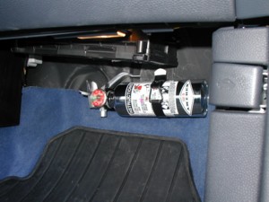

Fire extinguisher placement solution & roof decal
Gents,
Thanks for all the suggestions but I finally found my own solution for the placement of my Halogen fire bottle in the crowded cockpit enviornment. After checking that there was nothing on the other side of the firewall that would be affected by drilling, I found that just above where the carpet ends in the passenger footwell is a suitable place to install it. I of course checked that the bottle wouldn't interfere with a long legged passenger feet before drilling. This will provide immediate easy access and eliminate the possibility of the bottle becoming a projectile from the rear in case of an accident. The second photo preforated Canadian flag is see though and covers only the sunroof and helps cut down on the sun .
