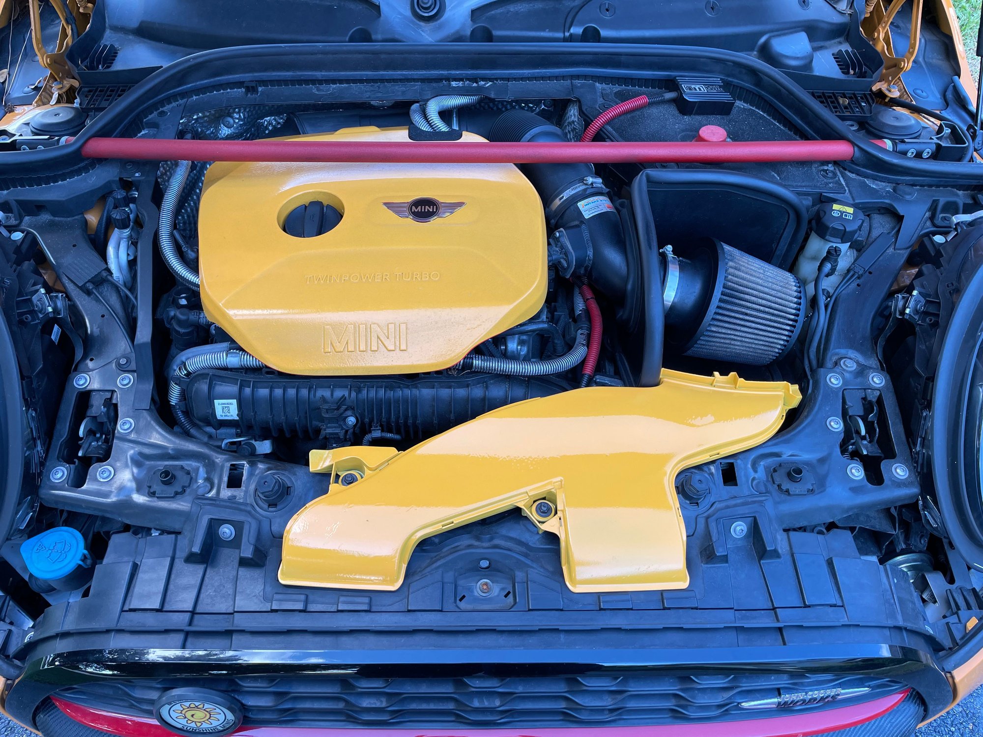

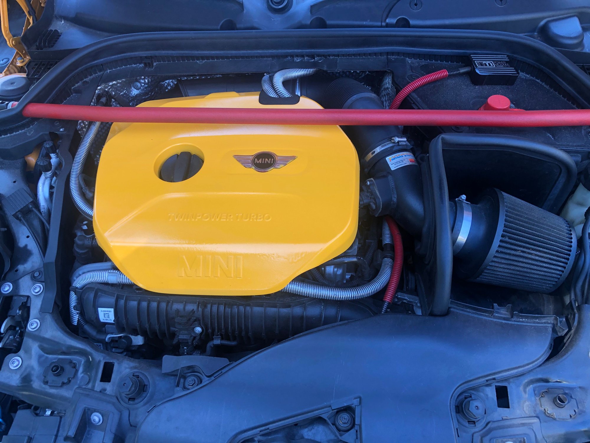

What type of paint did you use? Any special prep required?
Old Apr 1, 2022 | 04:21 AM
ASKtheteach's Avatar
ASKtheteach
Joined: Mar 2013
Posts: 1,034
Likes: 73
it’s just Behr Multi-Purpose spray paint from Home Depot. It’s meant to stick to plastics. The only special prep I did was to thoroughly clean the surfaces with soap and water and then went over them with rubbing alcohol. So far, it’s been about two years and it’s holding up fine. Color is “Blazing Bonfire”, which is not exactly Volcanic Orange (it’s a bit more yellow), but it’s close. I painted the engine cover first and then about six months later, I painted the under bonnet intake scoop to match.
