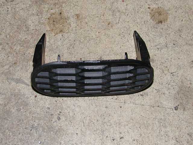

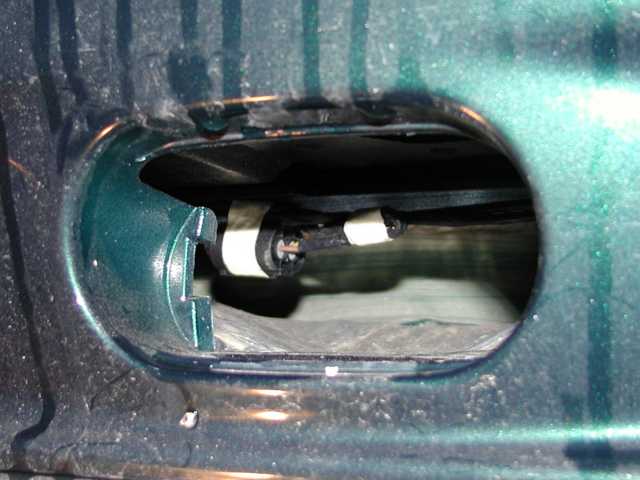

I installed mine yesterday. I took a bunch of pics and plan to do a write-up, but I'll put this pic up now because some people aren't sure if they've got the wiring or not.
I couldn't see the wiring from beneath the car because the heat shield on the S makes it difficult to see anything up there. But if you remove the blanking plate, you should be able to see it right away.
The blanking plate has two prongs that come out of the sides of it. (See pic below.) You can see where this clips into the bumper from below, looking around the heat shield. Press the ends of the prongs toward each other and the blanking plate pops out. In the picture below, you can see one of the places where these prongs clip in.
Once you remove the plate, you should be able to look through the hole with a flashlight and the wires will be right there. Mine had two pieces of white tape that were very easy to remove. The one on the right of my photo is where the wire was doubled back on itself, and the one on the left is the connector taped to the harness.
BTW, I was fooling around with it on the way home from the dealer, and my daughter who was following me said the light was really bright!

Last edited by LombardStreet; Jan 14, 2005 at 09:46 AM. Reason: added a pic of the blanking plate

Call your service advisor and give him/her your VIN number. (Or email Brian at Classic.) They should be able to tell you the exact day.
Or just remove the blanking plate and see if you have the wires. (See my post above.)

Thanks for the pics Lombardstreet! I now know that my 2nd week august build car does not have that connector taped there (wasn't sure what to look for). It does however have that other wire there that goes across the bumper. Does your connector splice into that other wire? or is the connector on its own seperate wire? It would be great if the connector was connected to the wire already there then we may have a chance that MINI may come out with an add on connector harness... Here to hoping...

I'm psyched - just popped out the cover and looked behind it and found the connector! I hadn't tried to do that before and couldn't see it up above the spare last time I crawled under the boot. Now to order the required parts....
