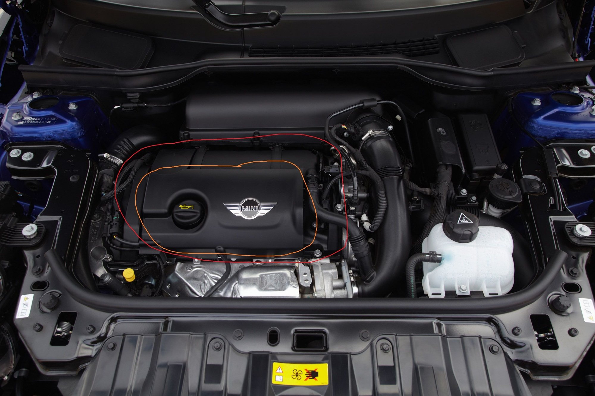

I'm thinking of making all the plastics that i have in my engine bay in carbon..for being more specific...
The plastic cover of the engine(Red)..+ the extra plastic that N18 has(Orange)..
The AEM filte scoop tha mounts under the hood.(orange)
The AEM filter cover/box (Red)
Besides the double engine cover+the filter box i have bought reflective gold tape for the AEM scoop in order to reflect the heat and have colder air temp.
SO..What do you think will provide me cooler intake temp......The stock plastic?Carbon? Plastic+Reflective, Carbon+reflective? If its possible mention your thoughts by percentage in order to understand the difference between them
The reason i'm asking is because i want to understand if besides the looks i will gain some lower temps...
I will do the covers just for the looks but scoop(air temp) i want to make it as gold as possible so i dont care for the looks more than the temp.
Thoughts?

The money you would spend on this project for better intake temps would be far better spent on a better intercooler and methanol injection kit.
Plus, trying to manage intake air heat pre-intercooler does basically nothing once you are actually in boost and that air is being heated by compression in the turbo. You're only going to notice any kind of difference when the car is just sitting still at idle not making boost, and there's no movement of cool air through the engine bay.

Then you've realistically done everything that's proven to be effective. Changing out everything else you've mentioned for carbon will have diminishing returns, if any. The specific heat/thermal conductivity of your valve cover and intake box are not the only factors at play here. You have to remember there's a giant block of aluminum (your engine) radiating heat into the engine bay at all times.
If you are truly after lower intake temps from here, your next best move might be to add hood vents. Assuming you're brave enough to start cutting holes in the hood.
