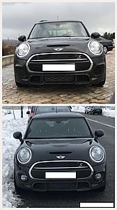

Does anybody know if you can replace the fog lights of the cooper s with jcw pack by the jcw air inlet covers oe:51117376117 and oe:51117376118

Old May 16, 2018 | 11:40 PM
narci's Avatar
narci
Joined: May 2018
[QUOTE = den_beire; 4389230] ¿Alguien sabe si puede reemplazar las luces antiniebla del refrigerador con el paquete jcw por las entradas de aire jcw? Ee: 51117376117 y oe: 51117376118
[/ QUOTE]
Bien, lo he cambiado, lo hice yo mismo, tienes que desmontar el frente y es un poco difícil quitar la parte detrás del foco, pero al final lo logras.
[adjuntar] 183340 [/ attach]
Attached Thumbnails change fog lights by jcw air inlet covers?!-photo-2018-04-14-15-15-48.jpg

You definitely can. I put a factory JCW kit (with the fog light covers) on my Cooper S. There was no issue taking those covers out and adding the fog light supports so I don't see why it wouldn't work the other way around.
Unfortunately, I had my body shop trash the unneeded trim pieces otherwise I'd offer to send them to you for free.
