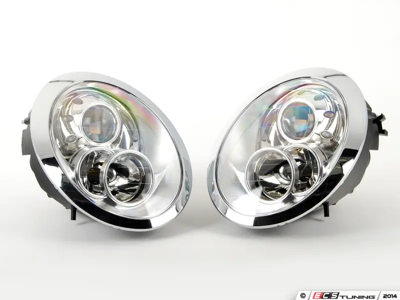

Depo in Asia has had some issues since the COVID 19. Right now they are backed up on certain items. We are trying to get more but there has been some major delays.
We do have the chrome ones in stock which you could then Joey mod.
https://www.ecstuning.com/b-helix-pa...ni01hl-cc~hlx/

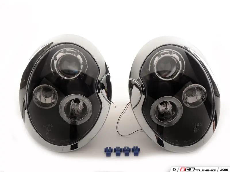

Spec D Tuning is another option:
https://www.ecstuning.com/b-spec_d-t...s/v-mini-2005/
Or spyder
https://www.ecstuning.com/b-spyder-p...-yd-mc02-drl-/
