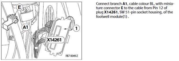

Solved: The crimp between the blue wire and gray wire at pin 12 wasn't making a good connection
I purchased the OEM Mini Cooper LED DRL/Foglights and took them to the garage to have them installed.
We are experiencing an issue with getting the LED halo to work. The top half illuminates for the parking light and the bright foglight portion can be switched on and works fine. However, the DRL function, with the full halo, does not work.

My guess would be ensure that the blue wire tapped to Pin #12 (Grey wire) of the 51 Pin footwell module is actually making a connection. Squeeze a pliers to the E connector to ensure connection. See DRL thread in the general section for more on this. https://www.northamericanmotoring.co...ls-fitted.html
