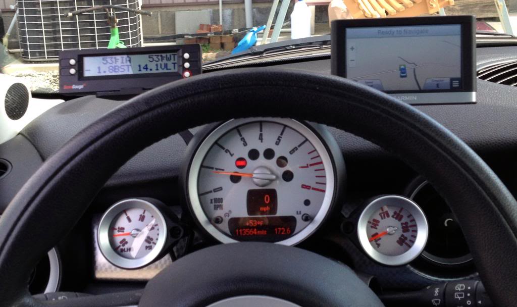

You would need to get an ODBII splitter cable and put a switch in to only power one device at a time. You cannot run both simultaneously.
Originally Posted by 05r50
So, I have a question. Are these gauges attached to your OBDII port and if so is your scan gauge also attached and working? How? I have read other threads where folks have said that you cannot attach multiples on OBDII because the car won't know which attached to respond to.
Does this really work? I am interested if so.
Yea, I have always heard the same but that picture shows that the SC and the Boost gauge are both active.
Correctamundo! No switch required. I installed a splitter I bought off Amazon. It's just one more gauge, just like multiple nGauges.
That's not 100% true. I am not the expert at the office, but this is my understanding;
The nGauge are all daisy chained to basically work as one. The Boost gauge, in most cases, is set as the master and is doing all the communicating with the ECU. That way, we can chain the 4 gauges and not have it slow up much.
When you hook up the SG at the same time they are both sending queries to the ecu and choking it up a bit. The only consequence seems to be a slower reaction time for both. I am not sure if there could be other potential issues with running both at the same time; I do know they will both be a little slower, but still useful.

The readings I'm using the scangauge for do not require an instantaneous reading. They are just for monitoring things like volts and intake air temp. The boost gauge follows the throttle and tach pretty closely and water temp doesn't need a second by second update. As soon as I get the nGauge oil pressure and volt units I will be selling my Scangauge II and my Cravenspeed mount.
