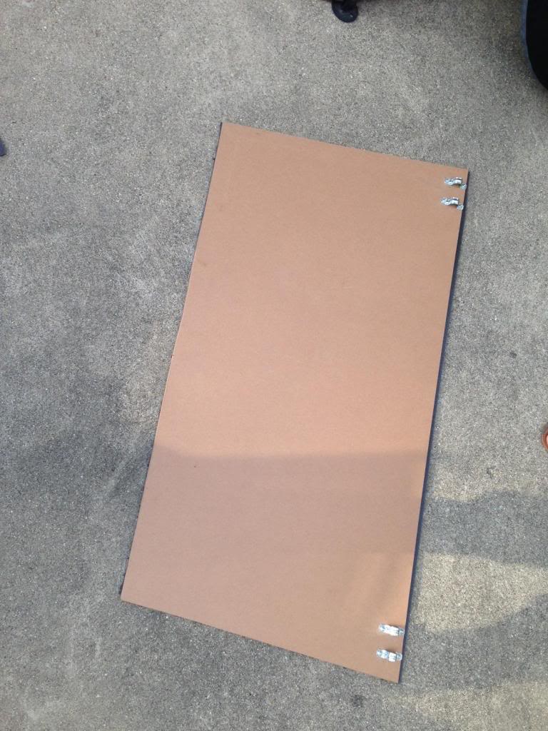

3. Bolt on the hinge rings on the board

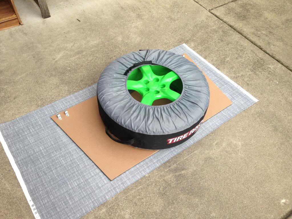

5. Fabric on, then press it with something heavy, used a tire to push it down and wait 30ish minutes.

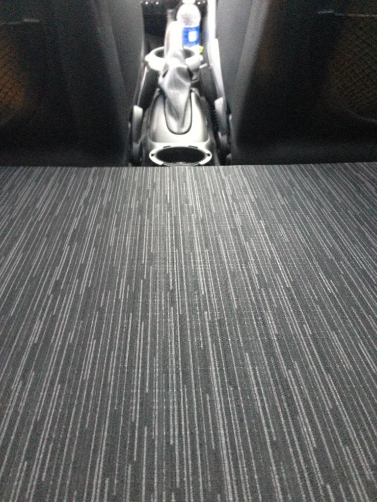

8. DONE!

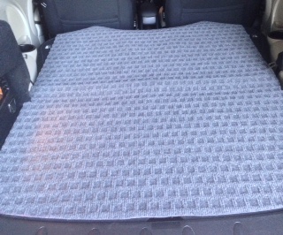

You coulda just bought a Clubman and be swimming in space just by adding a piece of carpet ($8 @ Home Depot and rubber backed) while still keeping your seats if ever needed and little bit of access from the side (behind seats with the 3rd door. Also, the MINI Cooper and MINI Cooper Clubman are essentially the same from the 2 side doors forward--they only differ from the rear of the two front seats to the back.
