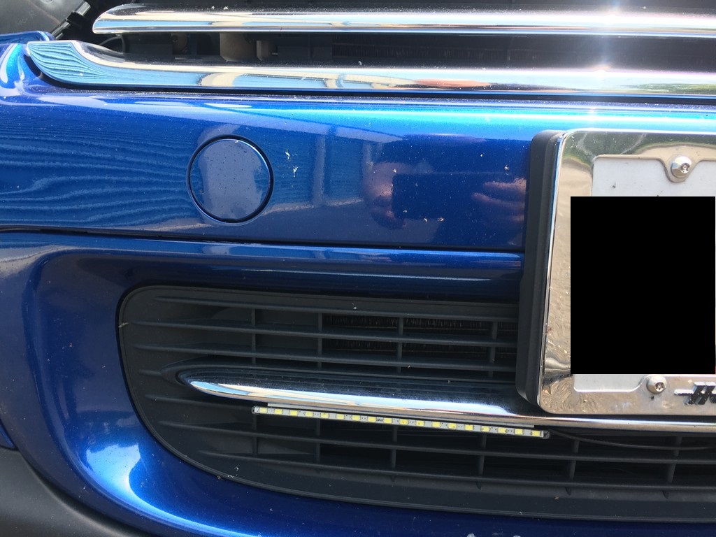

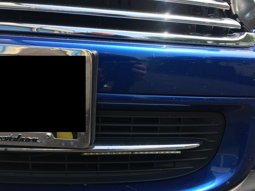

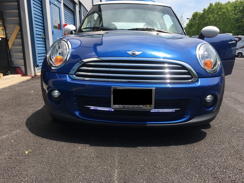

Mod #1 - DRL LEDs
Similar to what was shown earlier, but I did mine a little different.....
1st, I had the driving lights coded to act as DRLs (always on). I then replaced them with 194 LED bulbs I bought in a 10-pack from Amazon -
Amazon Amazon
I then ordered these from amazon & attached them as shown with the included double-sided tape & tapped them onto the stock driving lights so they are always on as well -
Amazon Amazon
Attached Thumbnails Dorky Cheapskate Mods - Gen 2-drl-1.jpg   Dorky Cheapskate Mods - Gen 2-drl-2.jpg   Dorky Cheapskate Mods - Gen 2-drl-3.jpg   Dorky Cheapskate Mods - Gen 2-drl-4.jpg

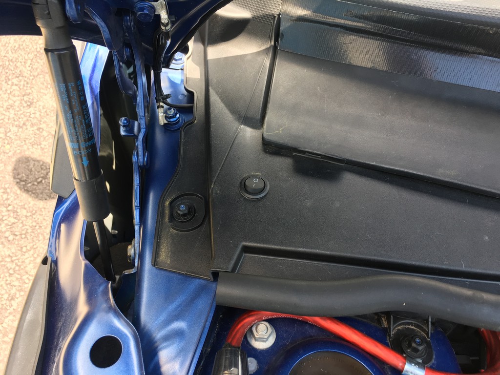

Mod #2 - Engine Bay lights
I took some of the strip LEDs like the others used in the earlier post for the DRLs below the headlights -
Amazon Amazon
I attached 2 of the strips to the underside of the hood for engine bay lights. I spliced the ridiculously small gauge wires to some 16 gauge speaker wire & then ran it inside to hood skin (as seen in the pics).
I added a simple on/off switch to the trim panel that covers the battery. I also used one of the quick-disconnect plugs to the backside so if I ever need to take that trim panel off to replace the battery or such, I can just unplug it & lay the panel aside -
Amazon Amazon
Attached Thumbnails Dorky Cheapskate Mods - Gen 2-engine-lights-1.jpg   Dorky Cheapskate Mods - Gen 2-engine-lights-2.jpg   Dorky Cheapskate Mods - Gen 2-engine-lights-3.jpg

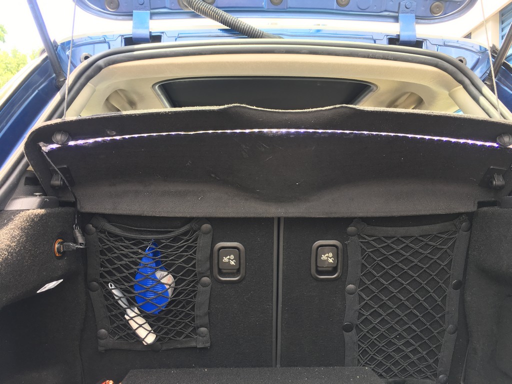

Mod #4 - Hatch Lighting
I took a LED strip that comes with a USB power attached -
Amazon Amazon
I used superglue to attach it to the bottom of the hatch cover. I also took the factory USB point in the rear & rewired it to operate with the stock trunk light. I simply unplugged the factory harness & just left it hanging behind the trunk trim panel. I then used "half-taps" to attach some 16 gauge speaker wire to the wires going to the stock hatch LED & then connected that to the power/ground pins for the cig adapter. BTW.....don't try to use hot glue. I tried that 1st & it worked great....until the LED strip was on for a few minutes & got warm & the stupid thing fell off & I had to then super glue it on LOL
Now both the stock trunk light & the LED strip come on/off when the hatch is opened/closed. If I ever need to take the hatch cover out, I can just unplug the USB power plug & lay it to the side.
Attached Thumbnails Dorky Cheapskate Mods - Gen 2-trunk-lights-1.jpg   Dorky Cheapskate Mods - Gen 2-trunk-lights-2.jpg

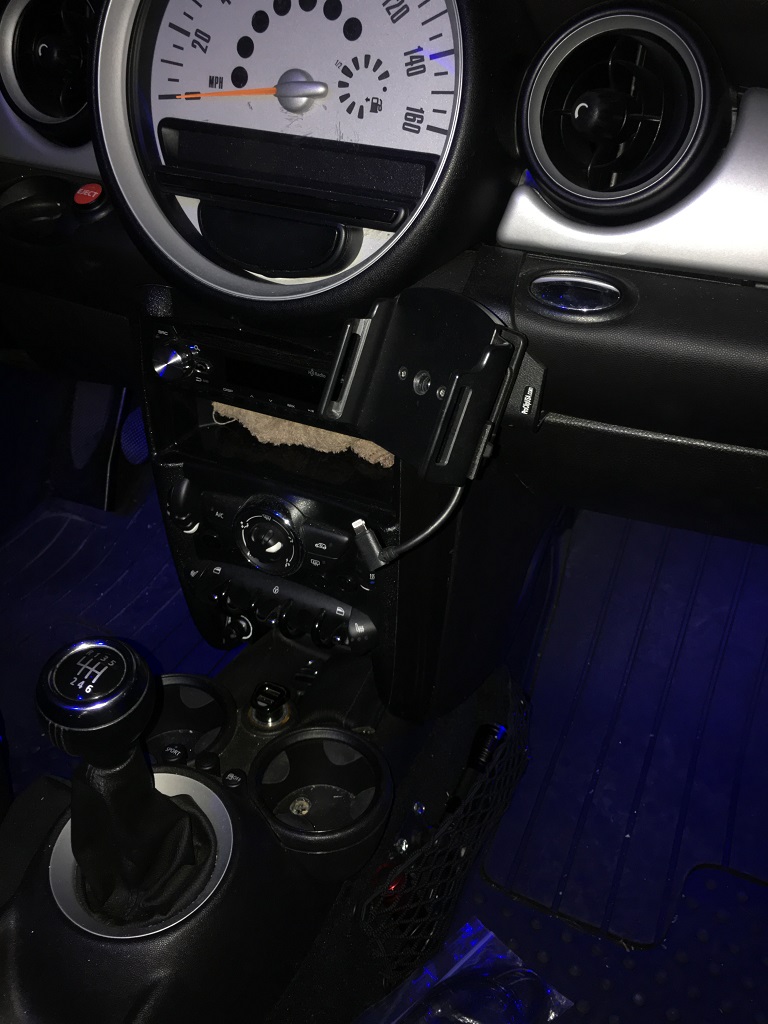

Mod # 5 - cig adapter power point
I took one of these & attached it to the upper footwell area on the passenger side -
Amazon Amazon
Power for this comes from it being spliced into the wires going to the cig plug in the console. I used these instructions from Cravenspeed.com - http://www.cravenspeed.com/product_i...RMC-0054-T.pdf
BTW.....the large red/black wire in the pic is going to my aftermarket speakers in the door
I have the Proclip.com iPhone mount. You can see the 6ft right-angle lightning cable that I have attached to the back side of the mount that hangs in position for when needed. That cable runs over to the radio riser edge & then black gorilla taped (so it's pretty much invisible) down & then under the center console up to this power point. This way, the cig plug in the center of the console is free if needed & the cables are hidden but always ready to be used. I am in the process of doing a RAM mount setup for my iPad Mini that I use for music & GPS that I'll be running the power cable for it to this power point as well
