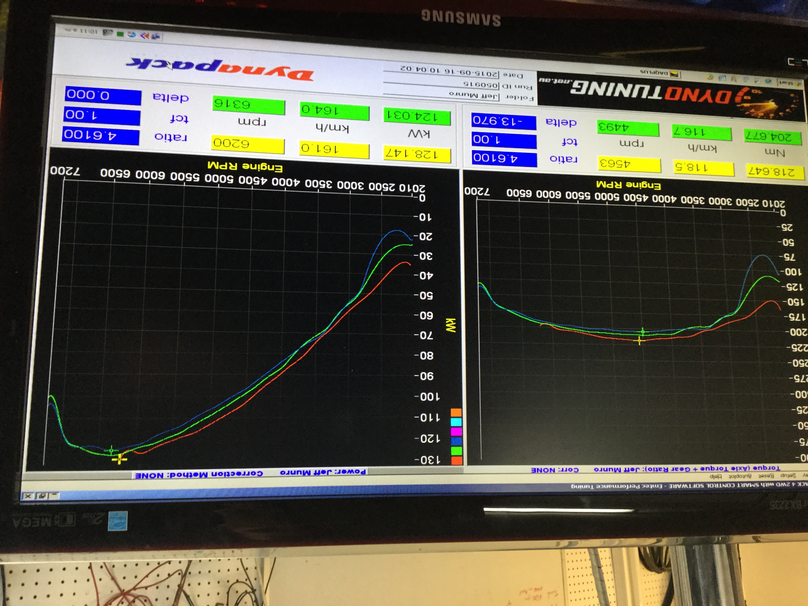

Hi all,
Performance question,
Just had my car dyno'd by a dynapac hub dyno the one jan at rmw prefers.
2006 R53
It has 17% pulley making 16 psi
RMW street cam
450cc injectors
RMW exhaust header
DDM works CAI
One Ball Exhaust mod
RMW custom tune
It made 172 whp!....
What? I really should have thought it would have made more... :(
Torque seems to be up there but lacking power.
Suspected belt slippage so changed to new belt which picked the psi up one to 16psi however it still doesn't have the go I expected.
Can I be missing something, I just checked the BPV too, good spring and it has an excellent seal at fully closed.
My brothers r53 just has the 17% pulley with none of the other mods and it easily keeps up with mine.
A little disappointing!

Yep, something's wrong with your car. If you post the dyno plots, I'll be able to tell if it's belt slippage. Even on a stingy dyno, like our Mustang MD250, you should show a lot more that 172.

You read the dyno graph upside down

There was some slippage on the dyno runs as you can see from these graphs. It was making 15 psi, we changed the belt and it went to 16psi, however 1 psi won't make a massive difference to the hp, maybe 9whp?
So I'm wondering even with the fixed belt whether something isn't right. As after I fixed the belt I did not notice an increase in power via the but dyno!

You have shown torque and fuel/air. It would be more informative in diagnosing belt slippage if you could instead show torque/power. Either way, I don't see clear evidence of the belt slipping in the shape of that torque curve. It looks like either the dyno operator is beginning the datalog at a very low rpm (sub 2K) or else the car is bogging at the beginning of the run. My guess is the former. You're not going to get any real benefit from starting the pull from such a low rpm. From 3k to red line (I see that you ran two pulls to 7.2k) the shape is what I would expect. The torque numbers are not way off. What was your peak HP number.

If you can look at the two previous posts there are two different power kW and torque graphs. Looks like it's making 130kw or 174 hp at wheels.

I looked at the power curve and it doesn't have the tell-tale look of a slipping belt, either. Check your belt and replace it: it's cheap, but I don't think that's your problem. One interesting thing would be to datalog to see what your boost level is. You could do that on the street with a OBD2 datalogger, like the Bavarian Technic tool.
