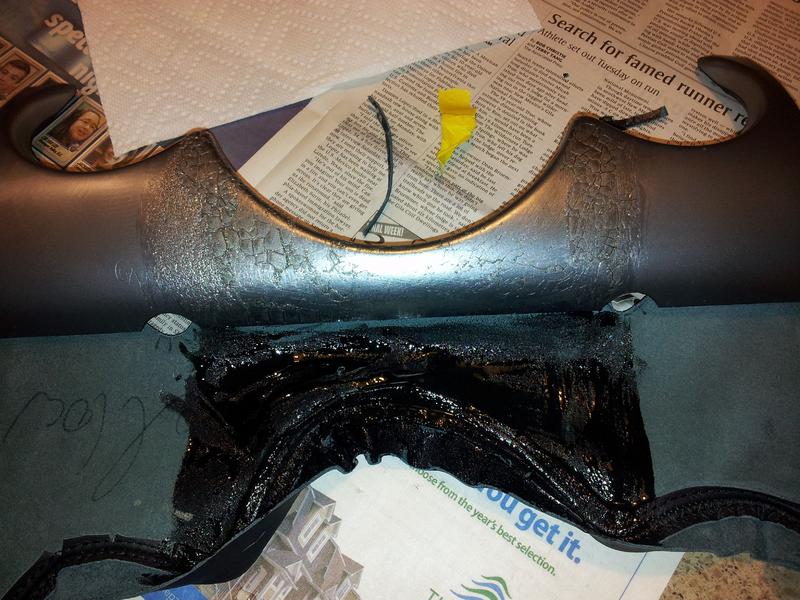

Installed mine on worn out dash used 3m contact cement. Install was fairly easy line everything up secure with masking tape flip one side over and glue.
Here is a picture of completed dash and never had anyone say it was ugly lol.
Attached Thumbnails Has anybody installed on of these?-20120401_202520.jpg   Has anybody installed on of these?-20120418_143927.jpg
