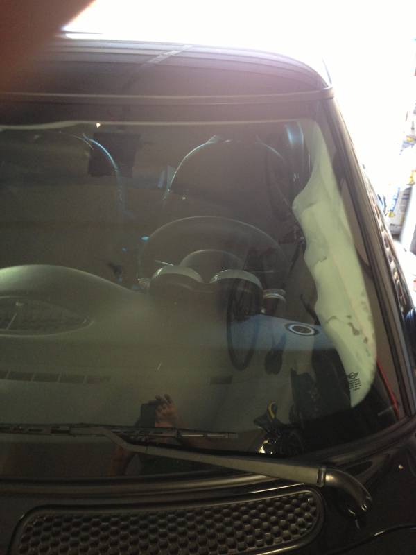

Started a project to make an A-pillar gauge pod of three gauges. Here's the first few shots of what I got done today.

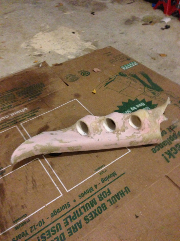

Great use of PVC pipe to create guage shapes anf then overly the fiberglass mat with epoxy or poyester body resin...Smelly but durable.. Hope to see that finall picts..

Got a bit more work done on it. Used some filler to level out the glass and allow me to sand it smooth. Layed down a thin layer of white primer so I can sand and find the low spots tomorrow.

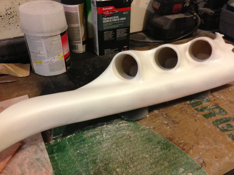

Did some final sanding and final fitting to make sure gauges clear and fitment into the car was good. Should be ready for some paint.
