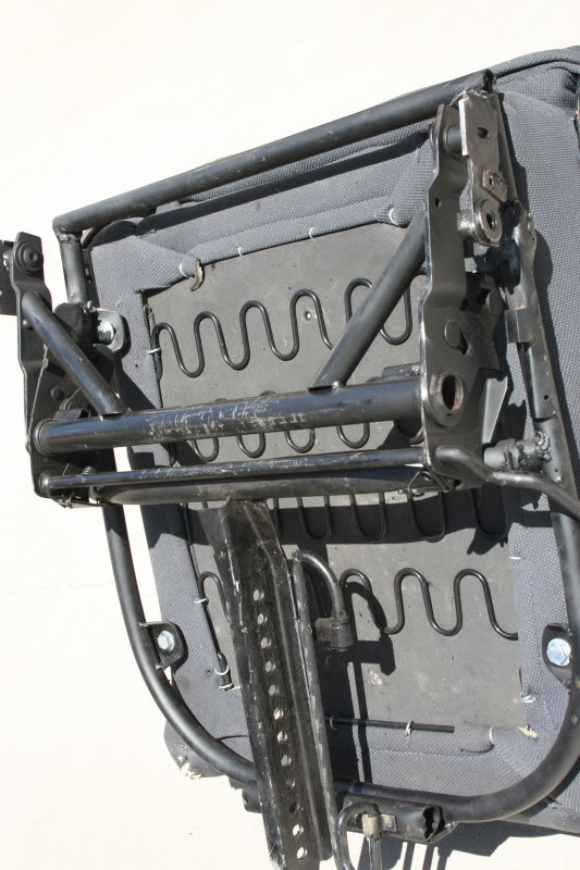

The MINI and VW seats have two completly different mounting systems. The MINI seats have sliders that bolt to the floor and VW's have channels built into the seat pan that the the seat slides into. Doing this swap is going to take a lot of fabrication. The best bet would probably be to weld the MINI sliders on the VW seats, but that means that the MINI seats will need to be cut up. I would definitely like to see it done though. Here is a picture of the bottom of the VW seats:

You just need to have custom mounts made to accept the VW seat mounts. Then have the base fit the MINI. That's how I had my Recaro's mounted.
The other option would be to by aftermarket sliders and mount those to the Recaro's and then have the brackets made to fit those and the MINI. Shouldn't be too hard, you just need a good fabricator which I think you have.

FYI, there are 2 types of Recaro seats found in Mk2 VWs. The first type (found in Jetta GLIs) have seat rails that bolt onto the seat base. The second type (found in GTIs) have the seat rails integrated in the seat base. The Jetta seats would be much, much easier to adapt to a MINI than the GTI seats would.

Fabrication should not be needed if there is a MINI specific seat base in the Recaro catalog. Remove the four silver hex head bolts that connect the black seat base to the underside of the seat frame and you should be able to mount a MINI specific base there.
