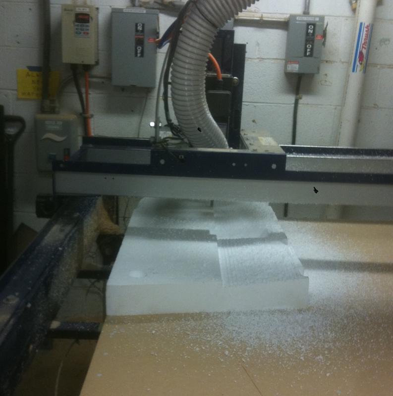

So the first step was to pull the rear seat backs and to remove the rear seat bottom. i also removed the center seat back mounting bracket. I then made a template that laid out the seating area and its relation to the rear cargo area. using that template i made a cutout of some expanded polystyrene.
I'm using the styrofoam to support a 1/4 baltic birch plywood platform that will span from right behind the front seats all the way to the rear hatch. The platform will be padded with 1/4 carpet padding and then black carpet matching the interior. I'm even thinking about a little special something - like the mini logo in the carpet.... we'll see
Attached is the polysty getting cut on our CNC machine at work to get the two planes of the backseat area and the cargo area to match up. i love my work toys

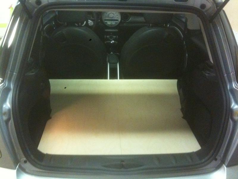

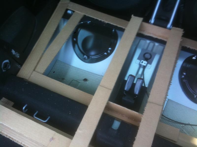

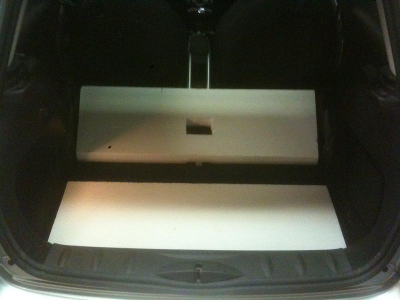

some more progress picts - got a shot of the the template i made to show some of the people who have asked me in messages...
also there is a shot of the polysty after i cut it out - it'll be held in place with simple elastic chord to keep it locked down, but simple to remove if needed. i also have a shot of the 1/4" baltic birch ply in the back after cutting it out and sanding.
