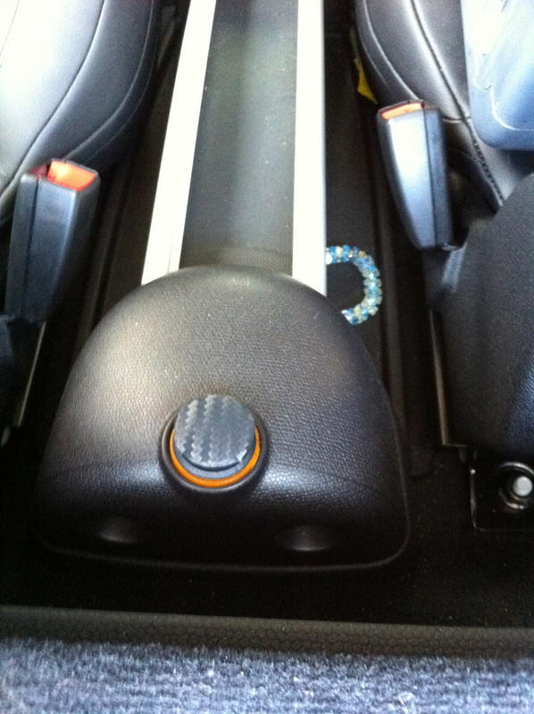

I have been eyeing up the 3M DI-NOC 3D Carbon Fiber Vinyl for a week or two and after ordering some samples I went for it and ordered 12 feet! I have wrapped my door panels, steering wheel controls and my center console (twice). I am planning on tackling the vents and Speedo console (Mickey Mouses Head).
This stuff is the most realistic carbon with a very visible herring bone pattern. Once installed it seems like the real thing. I had to convince people today that it wasn't real CF...
Here is a link to where I bought it. They have a great video of a Mini getting its mirrors, headlight rings, and roof wrapped. Which I think looks awesome in the end.
http://www.tiptopsigns.com/3M-DI-NOC...er-p-2472.html
Its supposed to have a 6 year warranty outdoor and unlimited indoor. So it should hold up well.
Here are some photos.. I will add more as I get more.
Attached Thumbnails Carbon Fiber'd the interior first photos!-img_1964.jpg   Carbon Fiber'd the interior first photos!-img_1969.jpg   Carbon Fiber'd the interior first photos!-img_1962.jpg

I have done vinyl stripes and I wrapped my tail light bezels before so I'm exactly new to it but it's fairly simple with the right tools. I am using the 3M primer 94 to help with adhesion and a lot of heat from the hair dryer. Don't forget a super sharp blade with replacement tips(you will need them)..
The door panels were extremely simple. Clean, lay it out, heat it up, press it on, and trim. The shifter bezel was very difficult. I had to do it twice so far. It started to shrink at the edges after sitting in the heat all day. I had trimmed it incorrectly which allowed that to happen. I'm now wrapping it around the edges to better hold it in place. We'll see how that works. So far so good.

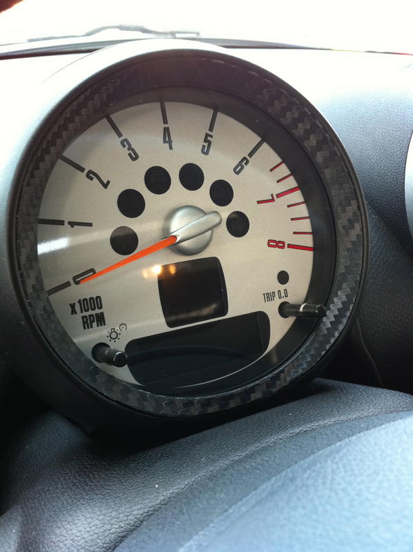

Here are a few of my favorite pieces that I did.. The tachometer is by far my favorite!
Attached Thumbnails Carbon Fiber'd the interior first photos!-img_2017.jpg   Carbon Fiber'd the interior first photos!-img_2032.jpg   Carbon Fiber'd the interior first photos!-img_2030.jpg

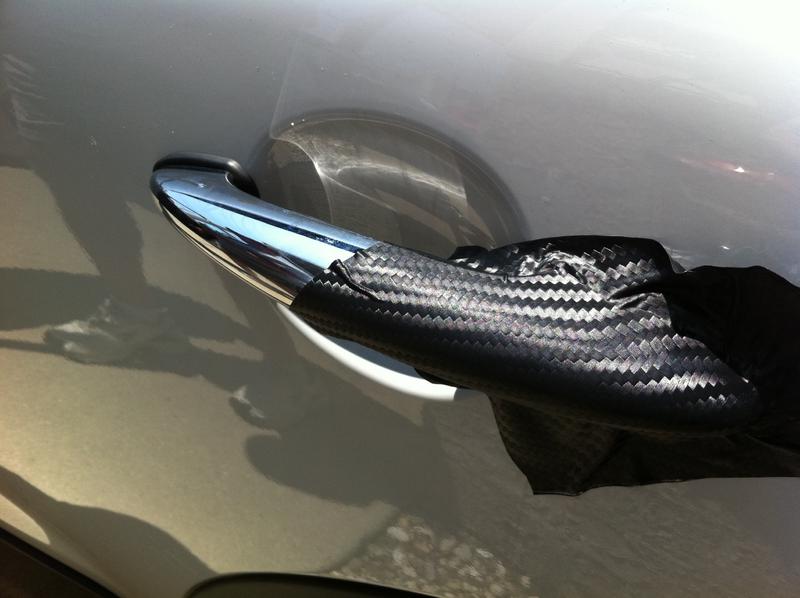

In the last photo I had a piece of scrap and wanted to see if I could even do the handles with this stuff. I may actually give it a shot. Its gonna be tough and I'm not convinced it will be worth all the headaches when I have to remove it.
Attached Thumbnails Carbon Fiber'd the interior first photos!-img_1966.jpg   Carbon Fiber'd the interior first photos!-img_2027.jpg   Carbon Fiber'd the interior first photos!-img_2006.jpg

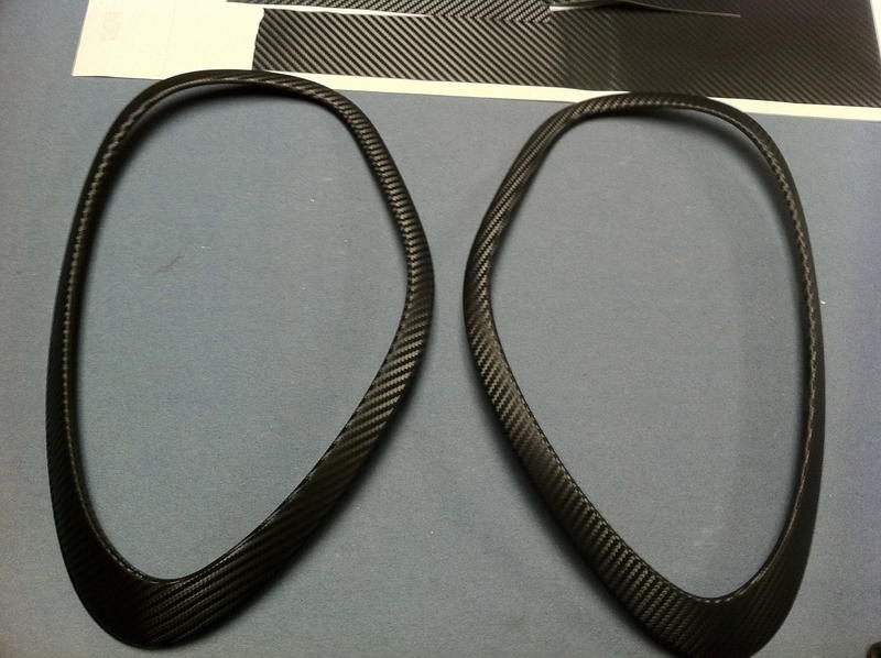

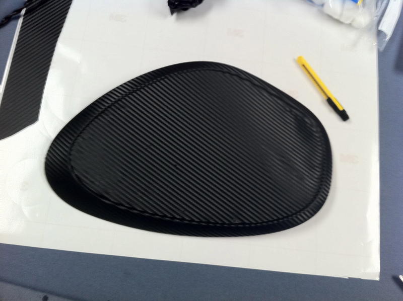

So I have a bunch of extra CF vinyl and a 2nd set of headlight bezels and I was bored. This is the result. Man did it come out nice. Way better then I expected. I glued and wrapped the edges and used a ton of heat. These should be on there to stay.. I just cant get over how real they look.. Let the bidding begin.. :-)
Attached Thumbnails Carbon Fiber'd the interior first photos!-img_2164.jpg   Carbon Fiber'd the interior first photos!-img_2166.jpg   Carbon Fiber'd the interior first photos!-img_2172.jpg

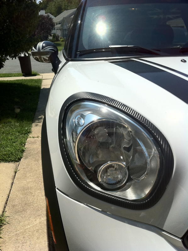

Got some time to install the headlight bezels today and what a difference. I wasn't sure I'd like the Carbon vinyl on the outside of the car with all the black, but IMO it looks fantastic.
Now Im gonna go nuts trying to do the door handles..
Here are some new photos.. One photo has one black and one CF headlight ring in place.
Attached Thumbnails Carbon Fiber'd the interior first photos!-img_2178.jpg   Carbon Fiber'd the interior first photos!-img_2181.jpg   Carbon Fiber'd the interior first photos!-img_2187.jpg
