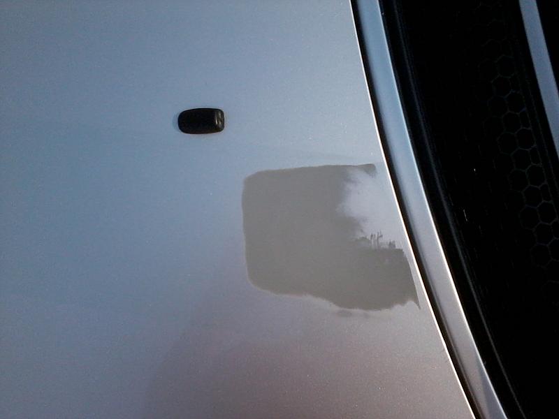

here some pics! the bad spot is on the drives side! it looks like the paint was heated up to me!
Attached Thumbnails Moss mini magnetic hood strips-img_20110609_131550-1-.jpg   Moss mini magnetic hood strips-img_20110610_165710.jpg

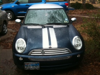

I'd go back with the adhesive vinyl. I had a company put viper stripes on mine and they came out looking excellent. If you use the magnetics you'll have to worry about fading, cleaning, etc. Other than the spot you have at the top of the hood is there fading?

are you 100% sure thats jot just dirty vinyl adhesive residue? in the picture that's what it looks like to me. give it a good rub, and maybe try some goo-off.

I agree with soccerbummer, it looks like adhesive, I can't imagine a heatgun causing that much damage from applying vinyls. With the amount of heat needed to damage the paint, it would melt and ruin the vinyl as well.

100 % sure!! i got all the adhesive off!! it under the clear coat!!! i dont think theres anyway of fixing it with out repainting the whole thing so i might just get a off center racing strip and cover it back up!!

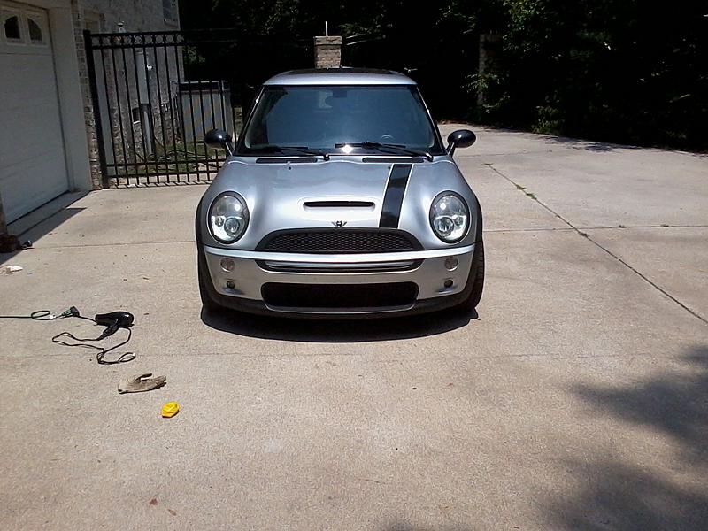

My offset stripe

looks good man!! im thinking both black!! btw which headlights are those?

Stock, I two toned joey modded them and put in LED accents under the little spots on top of the projector lens.

That is bizarre, but it is not from using a heat gun. You would have to keep the gun on one area and basically burn the paint to get even close to that, but it would look totally different. That and you would destroy the vinyl in the process.
I would suggest that the hood has been resprayed at some point and has reacted to the vinyl.
I had a red car once that had a white decal "tattoo" the paint with a slight blue tinge. If the stripes were on for a long time, it may be a reaction from that.
Come to think of it, I remember removing a wrap on an R53 that left a stain in the same position on the hood. What is under there? It may have had something to do with the ink though.
On another note, I had some magnets on the side of my car (Astro black) for about 3 weeks. One came off at some point on the 405, and it had left a "stain", which kinda looked like the magnet had drawn the metallic flake closer to the surface (under the clearcoat) and was lighter in appearance.
It did end up going away after a few weeks though (phew).
