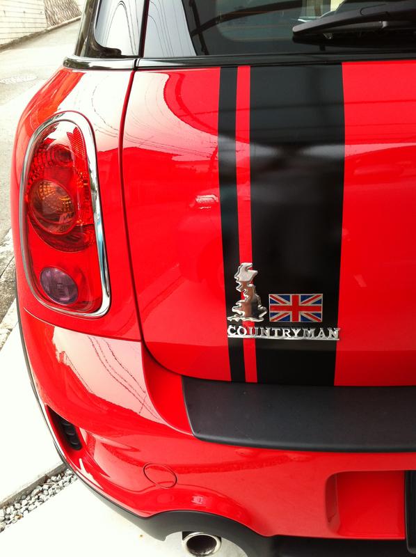

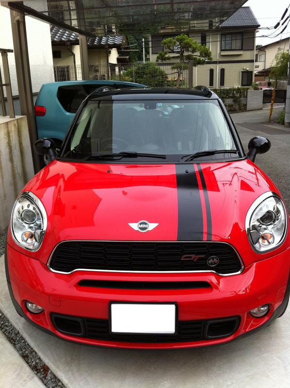

love the GB decal ...
Originally Posted by N.HAMAH
This is my New Mini Countryman with offset racing stripe
Attachment 62156
Attachment 62158

What's the source of the matte black stripes? Any vinyl shop?
Old Jul 11, 2012 | 01:31 AM
  #103
N.HAMAH's Avatar
N.HAMAH
Joined: Feb 2012
Posts: 3
From: Japan
Please check the following URL.
I bought two set of stripe kits.
http://www.outmotoring.com/mini-coop...tripe-kit.html

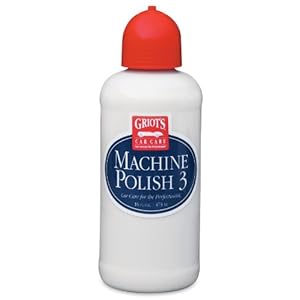

I totally concur! Vinyl is fairly impermeable. Remember that to rust under the stripes would mean that there would have to be exposed metal under the stripes. If there was pitting or irregularities at that depth in the paint's surface, your stripes would show depressions where the irregularities are. It looks like the surface is smooth so...I believe you're looking at stains on your vinyl.
As Mojito has stated, you need a very mild abrasive to remove the stains. I have used Griot's Machine Polish #3 on a soft cloth for stains like these and it works like magic. Remember that after you have cleaned the stains, make sure to put several layers of a good wax.
I prefer synthetic formulations and especially like Klasse. They have a polish and a sealer. The polish is a mild cleaner and a polish while the sealer is just the thing you need to protect the stripes from staining. The white stripes on my '04 R53 JCW are as white and shiny as the day I bought the car.
Griot's Machine Polish #3:
Klasse Polish:
Klasse High-Gloss Sealant Glaze:
