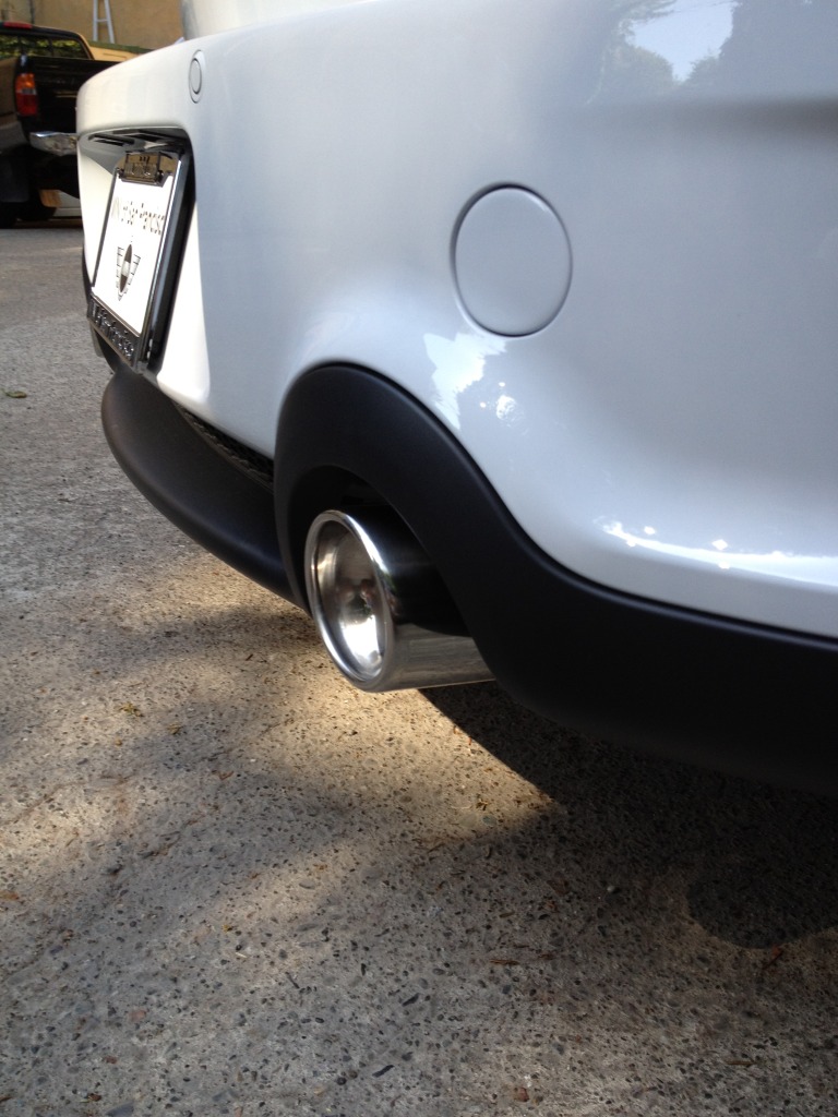

I wound up going with 3.5" rolled double-wall slanted tips on mine to give it that OEM+ look. Inspired by some other posters on hear, the tips are rotated a bit to follow the curve of the bumper cutout. I'm really pleased with the results- looks far better than stock and doesn't scream "I've modded my exhaust!"

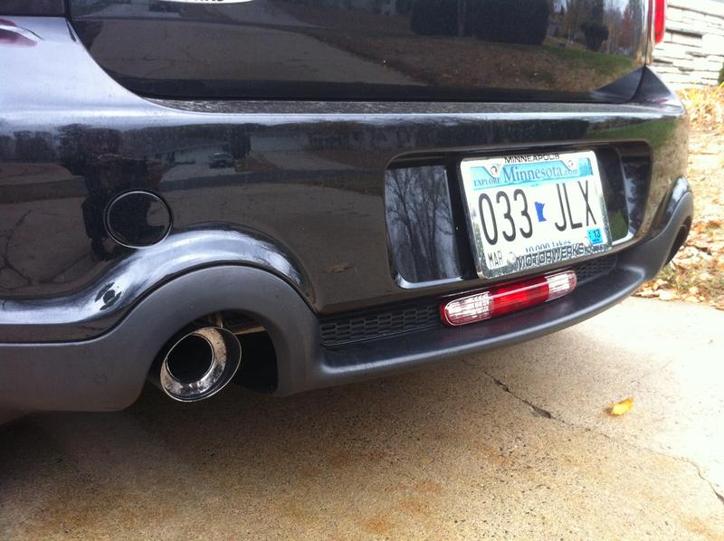

Has anyone who has changed the exhaust tips had the TPM ( tire pressure monitoring ) system malfunction after it was done? My TPM system stopped working and the dealer tried to say it was caused by welding the exhaust tips on. I completely removed the exhaust system to weld the tips on, so I said it wasn't possible that I did anything, but I'd like to know if anyone else has had this issue. They've had my car for 4 days now and still haven't figured out what the issue is, but they said if they have to call Mini for a Field Service Engineer, they will probably come out and look at it and say it's from the exhaust modification and say that it shouldn't be covered under warranty. I only had it for a week before this happened!

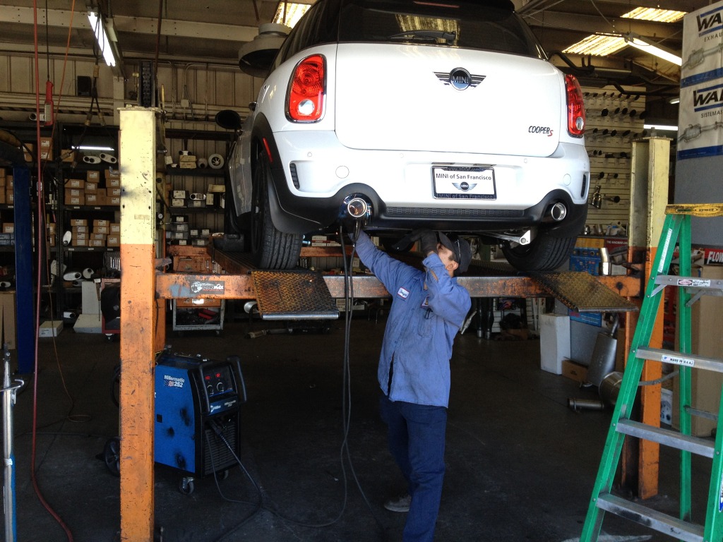

Digging up an old thread...but thanks for the info!!!
This was an easy mod. The shop didn't have any generic tips,
so I ordered Vibrant 4" #1207 tips from Summit Racing. 20 mins in and out!

If the dealer (who I'm very familiar with) had checked, on driver side rear corner is TPMS antenna which when you had exhaust down, it didn't get reconnected. Easily done - found out when helping a bud adding rear JCW spoiler to his Countryman. PM me & I'll get you copy of install directions. Btw I did the JCW tips.

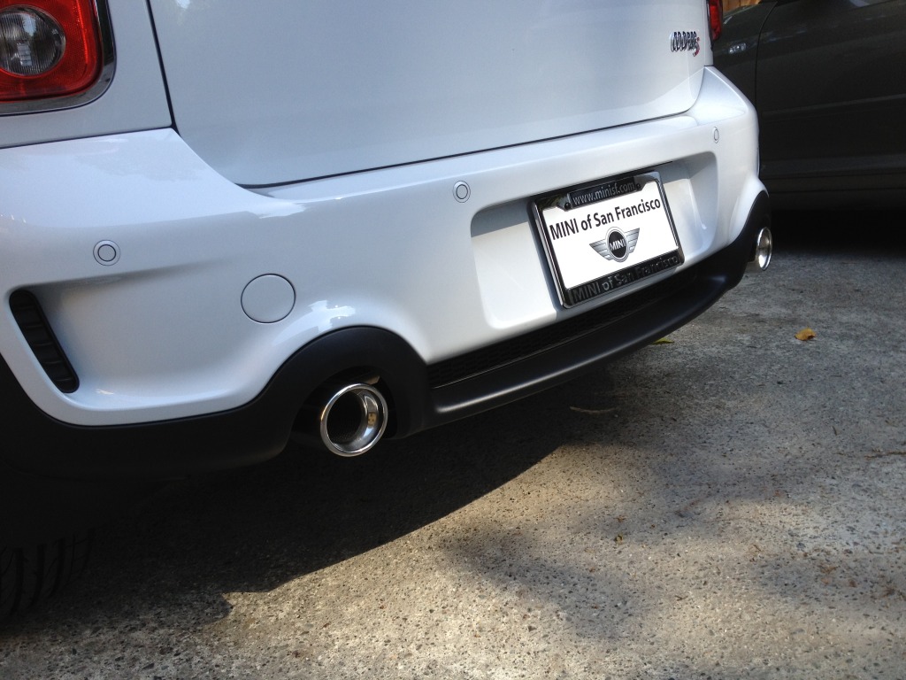

here is a photo of my 100mm (3.9") exhaust tips on my milltek exhaust
scott
