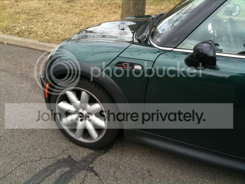

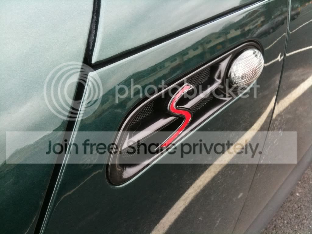

Here's the pics. I used krylon fusion glossy black. Me and a friend taped taped over the S but we couldn't get it perfect so that's why you can still see a little chrome. The turn signals are also slightly tinted. I used this vht tint spray. Just a heads up the stuff runs like crazy and because of that I only used one coat. Oh well

looks pretty nice!
What I did when I painted mine, is just painted over the S and then you can contact Lyle (lylesvinylstyles.com)
and get new S stickers to put over them, i got body color, but I am sure he could get you any color you want.

I had the same problem with my "S" I taped over them and peeled off the tape on the passenger side, but left the black on the drivers to see which I like better

Thanks for the info. Maybe I'll eventually spray that area over and get the S in green.
