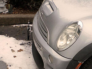

Seeing the price of current no holes solutions, I couldn't justify spending that much for something so simple. I decided to utilize the OEM tow hook in addition to a plate frame I had from my old car. I bought some angled aluminum from Home Depot for about $6, and all the hardware you can see in the pictures. This is what I came up with:
The prototype:

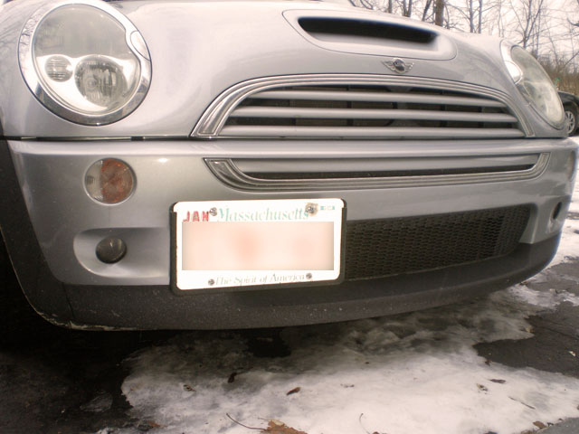

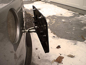

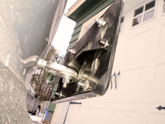

... and the final piece painted. I cut down the bolts, added random caps I found at my house. I still need to cut down the bolts holding the plate to the frame and find some caps for those. I would like it to sit closer to the bumper, but for under $10, I'm not complaining.

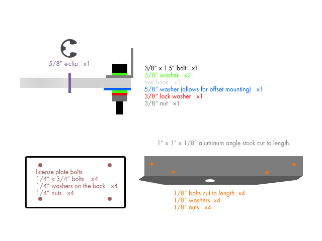

Not really sure of the hardware sizes, I kind of just grabbed what I thought would work. Tools were just basic sockets (12 and 14 I think I used) and screwdrivers.
The bolts holding the bracket to the plastic frame should have small, round heads so the plate can slide over them with little force. The whole thing is pretty much cut and drill where you see in the pictures.
I'm not entirely sure where you can get a license plate frame like the one I had though. It came with my old car about 6 years ago.
As for aligning the tow hook so its parallel to the ground, use one of these snap rings (5/8"). Its the one on the right:
http://faq.f650.com/FAQs/Photos/Chai...pRingEclip.jpg
It's really a straight forward process. Very easy. Shouldn't take you more than 2 hours + painting time.

Ok here is my very crude, late at night illustration. The bolt lengths could be slightly shorter (reduce the big bolt by 1/4", maybe 1/2" and reduce the license plate bolts by 1/4" to 3/8"). You could just cut them down, or buy them shorter. Not really an issue.
You could use this license plate bracket found at Advanced Auto and modify my design slightly by drilling the bracket holes in different locations to make it work. It would probably look cleaner as well, no bolts sticking out the back.
