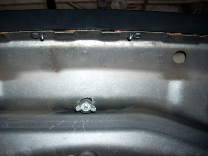

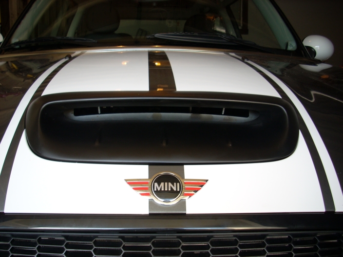

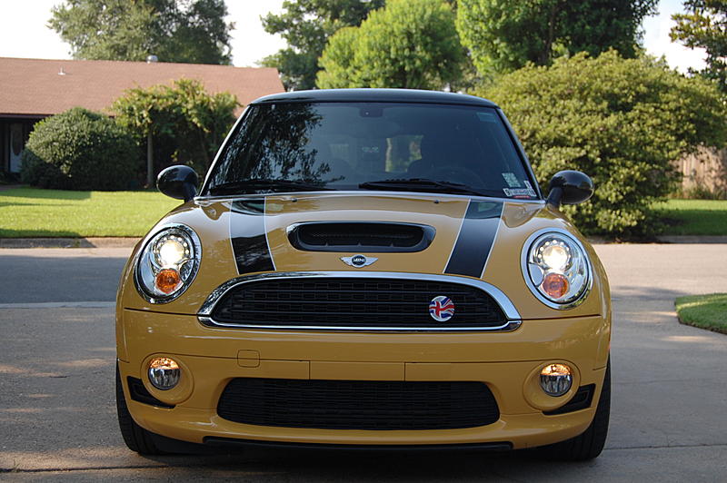

Man...it was a pain:
The on-line instructions were helpfull but needed a little more info to be perfect. Like indicating the size of nut so users know what socket to use.
The washers could have been larger so it covers the existing holes completely for a secure fit.
A larger drill bit. According to the instructions, users are suppose to drill from the engine side of the bonnet to make a hole large enough to fit the socket. The 1/4" bit didn't help. Most of the installation time was spent using the drill bit to make the initial hole wide enought for my socket. A drill bit that would drill a hole large enough to accomodate a 3/8" or 10mm socket would've saved so much time and sweat, and would have resulted in a cleaner drill hole.
Once I installed the screws the front screw and washer didn't tighting the scoop down enought so it moved side to side. Looking at the screw and washer it screwed all the way flush to the sheet metal inside the large opening made by the drill. Now I can't get to it and I had to rig an attachment straight to the bonnet. Now it's snug and doesn't move, but the detail is ugly.
Lastly, looking at the scoop head-on shows an ugly detail. It looks unfinished. You would have thought they noticed this and added a nice black mesh.
Vince

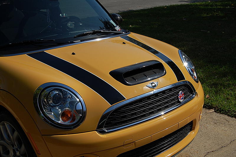

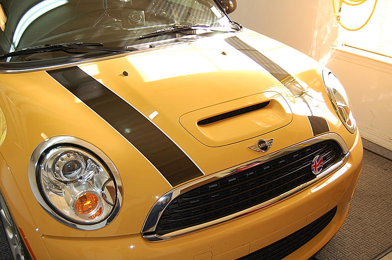

M7 Vortex 2 Scoop

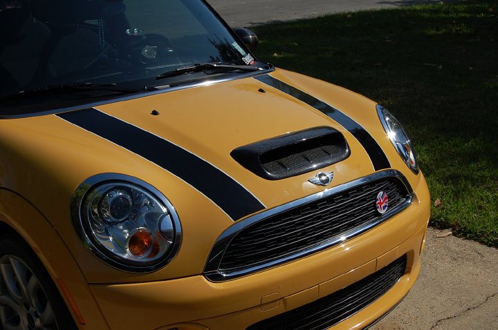

LOVE IT!!!!

M7 Vortex 2 Scoop
Works very well with the CF mirror caps. It is not near as aggressive as I thought it would be which is great! I think it looks edgey without being gaudy. Took awhile to get it in but well worth the wait in my opinion.

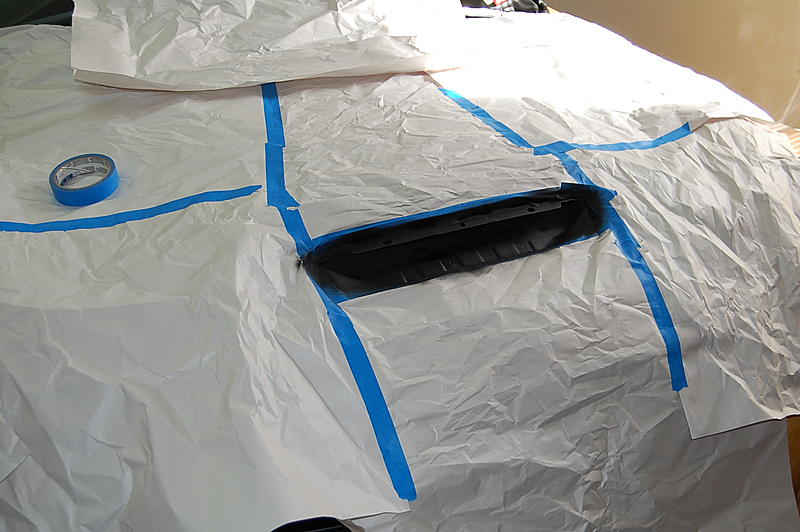

Yeah I think that some just like to whine for whatever reason. Really this is a very easy and straighforward evolution. Unless you have no mechanical skill at all, this will be a breeze. Just take your time and put a towel or sheet over the engine so any screws, washers or shavings dont fall into the engine area. I did paint the hole with flat black paint and in fact I used the packing paper that came with the scoop and painters tape to mask the whole. then I put towels around that so no overspray whatsoever would get on it. At first I didnt put any of the "gutter mesh" in there and I happened to be at Home Depot and saw some and so I picked it up since it was only a couple bucks. I then took it and cut it to the rough width of the hole in the Vortex scoop. Again, I didnt go rocket science on it and I just slid the mesh up inside the top of the scoop and folded it down over the hole in the scoop. and then left it long enough so that it basically sits on the same lip that the lower part of the scoop sits on and that essentially holds the mesh in place...no gluing or screwing anything into the scoop. I then mounted it on the bonnet and voila. Dont screw it down too hard or it will fracture the scoop and you will hear it but by that time it will be too late. I am glad I put the mesh in...looks finished and professional. Unless you are mounting a blower on the car you wont find a factory scoop without mesh so I think it also looks "right". It also keeps a lot of the bugs out of the inside as well. The whole shabang took about an hour, if that. I dont see drilling a hole on the underside of the bonnet as a huge deal although some on here think its a tragedy. I didnt use a step bit...just a few bits making the hole a little larger every time until I was happy. I also used a paint pen to paint the nut and mounting screw end so it looks a bit cleaner when you look under the bonnet. Other than that, it is not a big deal at all. Hope this helps.
