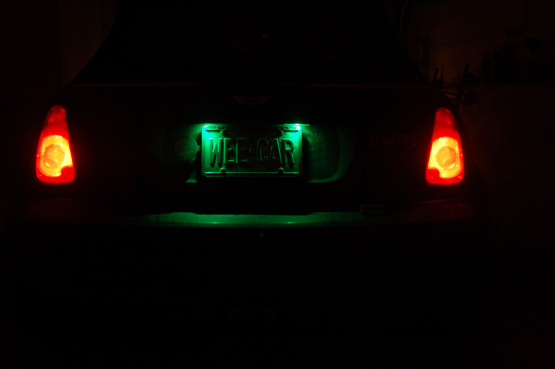

I just did this mod myself on our convertible. I have to say I'm a bit underwhelmed with the brightness of the LED's although mine are all green (to match the car). I installed them in the boot, glovebox, puddle lights and the rear licence plate.
I'm really thinking of at least putting one of the original bulbs back as although it looks cool, I'm concerned about the legality due to the poor visibility.
Has anyone tried the extra bright colored LED's?
(Apologies for the dirt, it's way overdue a wash!)

IIRC, the factory bulbs don't do a much better job of lighting the plate. Just make sure the LEDs are facing the proper direction. Since they are directional, they need to be properly aimed.

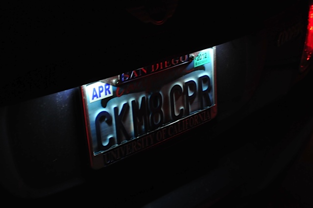

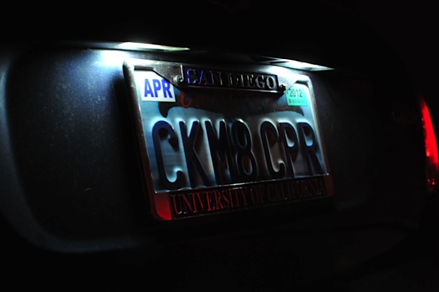

Here are some pics of my rear license plate LEDs. Please do not mind the dirt on my car. It was raining over the weekend and I haven't a chance to wash her yet.
Attached Thumbnails LEDs for rear licence plate?-wdp_7795.jpg   LEDs for rear licence plate?-wdp_7823.jpg   LEDs for rear licence plate?-wdp_7824.jpg
