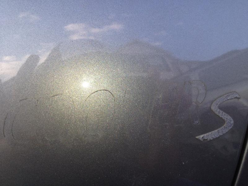

I appreciate everyone's input on debading; so I decided to take pics of what I did and show you all what I did.
1. Used a blow dryer for about 30 secs on each letter and then used Dental Floss moving up and down while moving to the right. Come to find out I only really heated the first letter and the remaining letters I didn't have to heat just using floss removed them from the car. However, still needed to heat the adhesive to remove it fully from the car. Probably should of heated the letters like I started to from the beginning and then I wouldn't of added an extra step.
2. Then I used Griots Garage Adhesive Remover and completely got the excess residue off of the car which would be the exterior showing of the letter, refer to pic 2.
3. Then I washed the section of the car where the badge was removed using Meguiar's Car Wash.
4. Then I wax the section of the the car where the badge was removed with Zymol Car Wax. I did 2 coats of wax.
Now it looks like the badge was never there.
Attached Thumbnails Debadge or not to debadge-img_0524.jpg   Debadge or not to debadge-img_0526.jpg   Debadge or not to debadge-img_0530-1.jpg

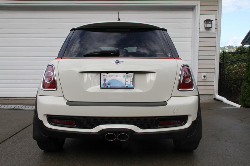

I de-badged mine to make it much easier to wash, dry and polish!
