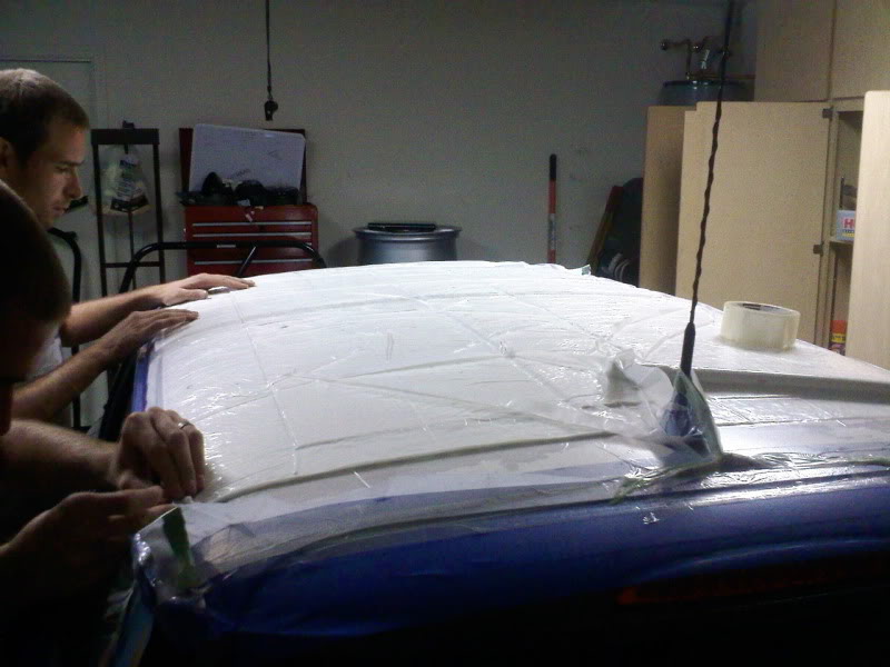

Hey Brent...here is a pic from last weekend...The mold came out PERFECT from a non-moonroofed car. Thanks to Wes for letting me borrow the car!S! Roof skin cap and glass replacement options on the way shortly. Wes will get the first cap since he was kind enough to let us borrow the car.... ETA is whenever the Double Mint twins get it done...

nice work by all who are working on this product. just a word of caution for those who would take it to the track. when cf is involved in a shunt, it fractures and sends sharp fragments flying. a roll cage will not protect you from these. a properly designed core material, or better yet, a layer of kevlar, will solve the problem. the addition of kevlar will make the cf behave similar to safety (laminated) glass vs. plate glass in a crash. i will be fabbing a lot of cf parts for my race car build, but have decided to install a non-sunroof steel roof skin.

Thanks for the heads up but if one can accomplish work like this Im very sure they know the characteristics of composite.... And Kevlar is heavier and more brittle as I understand it. Have you ever had a raw CF splinter in your finger? It hurts like a **** . And on the roof skin...I was gonna go that route a long time ago but I wanted to do something different. Plus, I like the hole. So, I still unscrew it and put it in a padded bag. Then it will almost be like a vert...

Just a comment. Bean is quite correct about the danger of CF.
Kevlar is not brittle in the least as it does not absorb the resins like CF does. When CF shatters, it does just that, but when Kevlar is struck in the same way it almost reverts back to a cloth. Once Kevlar delaminates you just can't repair it, hence why some very expensive and extreme racing sailboats sit worthless in marinas for about 1 cent to the dollar.
In building my CF doors I used a layer of heavy weight kevlar on the inside in case of impact. The Kevlar will keep the carbon from slicing me up in a side impact.

an alternative to aramid fiber is Spectra. You can't use resin to mold it in like aramid fibers but it will be a CF barrier (better than aramids actually)
Can't answer your phone but can post pics on NAM
I coulda been there for this, answer your damn phone!!! Looks sick though for sure!!! Now take off the take and plastic so we can see the finished project
