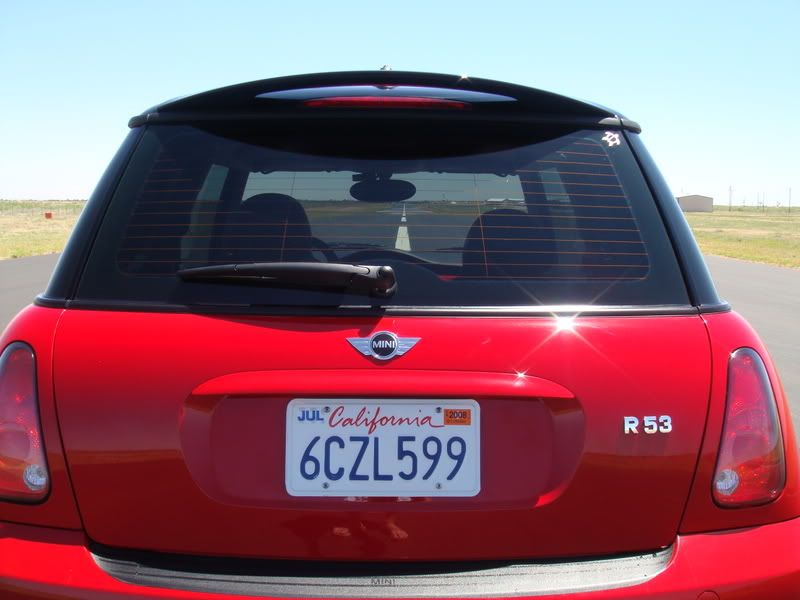

Heres what mine look like after a year....

If you want I may have some time to photoshop yours...it should be pretty easy. Post up a pic and I'll try to have it done by tonight. For now, here is how mine look.

Here is mine.. if you have time please photoshop it

The left one was giving me a little bit of trouble. I could probably re-do it to make it perfect, but I figured this gives you a good idea.
YEAH !! It's OK. Thanks!!
What do you think ? do you like it black guys? i don't know because of the white roof..
