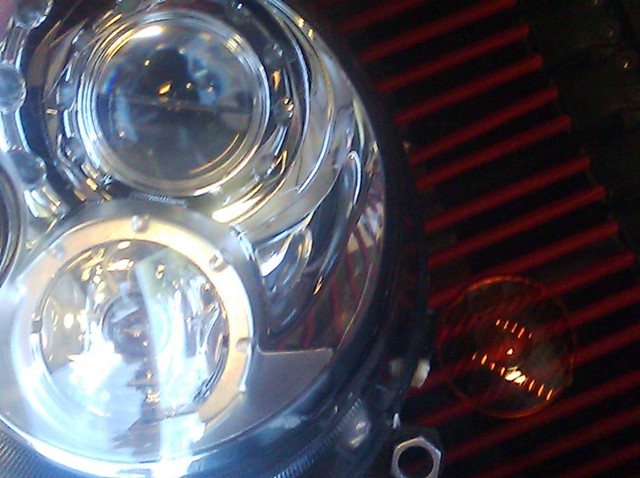

Pulled mine off an 09 MCC with Xenons. 4 screws, pretty simple stuff. The last screw in the corner was a real pain. When I couldn't get it I just snapped the little base. I owuld have gotten a diagonal extension but got lazy. Wasn't really a big deal. When I screwed the other 3 back into place it was VERY secure. Anyway, after pulling it off just using a small flat screwdriver you pop the little tabs on the amber reflector and it comes right out. Put amber bulbs in after. GREAT mod.
