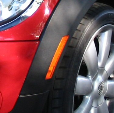

Originally Posted by Hellion
Think you could make a clear set of fender markers the same way?
You're talking about these right?
It could be done. A mold would have to be made for each lens or one mold with all 4 lenses. I haven't taken them out to see how hard the mold would be to make.

Yes those are the ones I am sure you could find a market for them if you could
i actually was going to do the same thing with these, but i pulled them out and was disappointed to find they are two pieces glued together. the lense, and a backing piece for the bulb to mount to. there is a space between the two where the reflector shape which you cant get to while they are together. so you will probably have to break the back piece to get the lense to a state where you could mold it, unless you just want a big block of plastic.

ugh ok...spray tint it's going to have to be. Thanks for the info!
