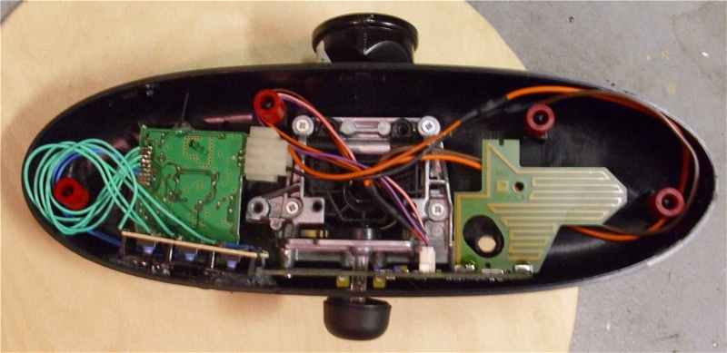

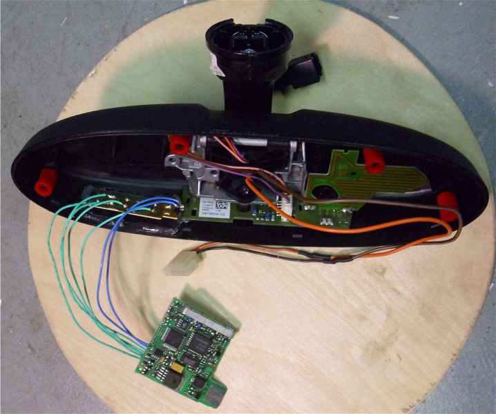

I followed DanQ's suggestion to retrofit my '07 with Homelink. Many thanks for the wiring suggestions. I took some pictures and experienced issues that others might run into.
First, getting the mirror off seems easy now that I've done it, but wasn't clear (to me) after reading other posts. The good news is that the mirror is designed to break away in an accident at the headliner joint (between the headliner and the mirror stand). Just grab that entire bugger, including the plastic and twist it clockwise, as view from the base. It should snap right off. Don't pull all the way down until you break the wire connector, which will become visible when the mirror pops off and drops. You don’t ever have to separate the mirror housing from the support stand at the ball joint.
DanQ had a little trouble getting inside the mirror. For me that was easy. I used two very small screwdrivers working around the top edge - one, then the other, then back to the first. Start at the top because small scratches won't be visible when you are seated in the car.
The key learning for me was that the flex circuit board between the push button housing and the homelink module tends to be less than durable. I bought two modules off ebay and managed to ruin both of them – or they were “iffy” before. This was especially frustrating because the homelink units tended to work intermittently, and I hate those kinds of problems. After hours of frustration with the first module, I gave up and purchased a second one, then suffered the same intermittent fate. Finally, even though the flex board looked fine under a magnifying glass, I cut the flex circuit between the two boards and hand soldered the seven wires. Bingo, it worked every time – love that.
If you are nuts enough to attempt the wire replacement, here are a few tips. Take a photo of the button module, print it, and mark the solder points 1-7 on the drawing. It makes things quicker during soldering. You’ve got to be handy with a soldering iron to attach those seven wires on the homelink module. On the button module, it is pretty easy as there is more area to work. Now that I’ve done it, and have an extra module, I’m thinking about locating the button module in one area and the transmitter in another – but on a different, non-mini, car. Enjoy.

Final Pic
I forgot to include a picture of the final result. See below. In some forums we talk about WAF (wife acceptance factor). I'd like to tell you that my sex life has improved, but frankly, she is asking: "what's wrong with a couple of remotes on the visor?" Women.
