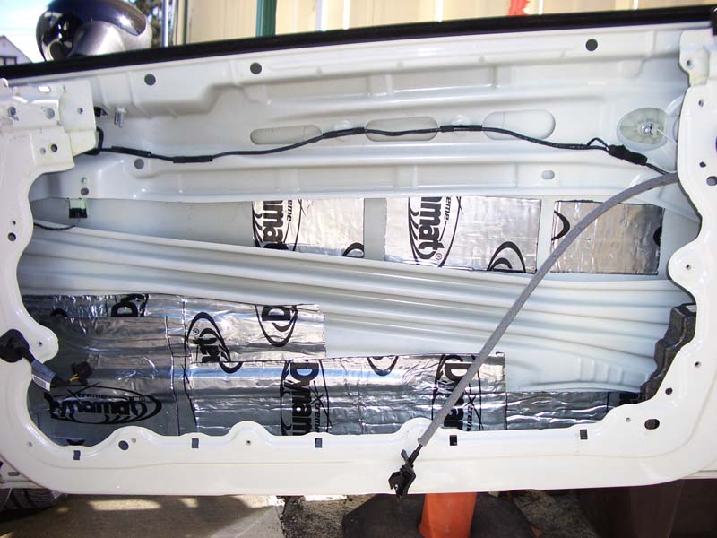

So I finally got around to taking apart the doors. Here are some pics of inside the door and of what I did.
As you can see, there isn't much flat space to cover with sound deadening mat. The foam stuff I used is Overkill and that other little square in the bottom left is a DynaXorb.
Attached Thumbnails Removing the Front Doors Windows-insidedoor.jpg   Removing the Front Doors Windows-dynadoor.jpg   Removing the Front Doors Windows-foamdoor.jpg
Nice job. Persistence and a little OCD pays off. Now you got me thinking about doing this. I will resist.
