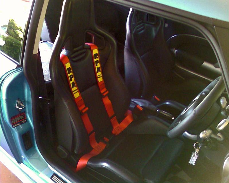

I have the Sportster CS seats direct from Recaro in my R53.
They are available from Recaro with the side airbags, but as ghosthound stated the issue in the US is the weight sensor in the passenger side seat due to the US seatbelt laws.
So, how do you get around that? Doesn't it throw a code if they are not connected?
it actually easy to do the weight sensor. Harder part if finding a mid '05+ seat as a donor. You only need the lower section....you have to cut the sensor and control module out of the foam and install it on the lower Recaro cushion. Here's mine:
OC3 mat extracted (laying upside down on the new seat):
installed pics:

^^ I never knew your recaros had side airbags! Im assuming you only need the donor seat if you want to keep driving the car during your install, assuming it takes more than a day or two to get done.. otherwise you could just chop up your own seats right?
I would love to get some more supportive seats but would much rather have the safety of the side airbag.. looks like it might be possible to have both!
Old Apr 18, 2008 | 11:09 AM
PGT's Avatar
PGT
iTrader: (11)
Joined: May 2006
Posts: 7,681
From: DC Metro
no, although mine are from a 2007 Mitsu EVO IX, no airbags. I moved the OC3 mat over from a seat I bought on ebay from a junkyard. I have a 7mo old daughter and down the road, she'll be riding shotgun (not to mention my dog already does go on short trips to the store with me...he doesn't need an airbag going off in his face )
