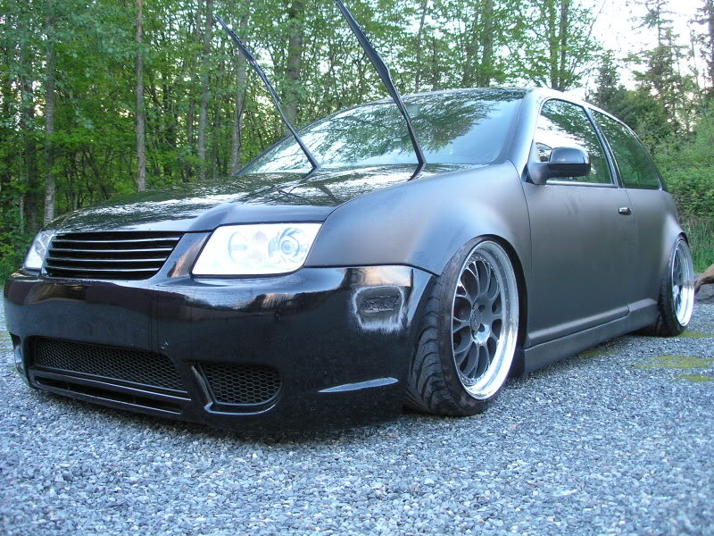

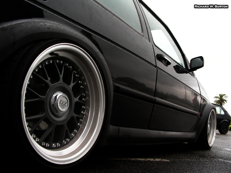

Or you could spend big bucks like this VW Or imagine using this same method on the plastic arches with fusor and abs instead of welding metal. This is very OEM+. It basically looks just like stock, it just extends an inch further out. Nothing too crazy like you'd see in the fast+furious

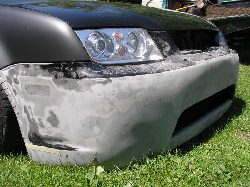

what are the vdubs doing to widen their plasitc bumpers to match their finished metal flares? Fusor and abs?
Depends how far they extended the fender. For minimal pulling of the fender, they usually just make cuts every inch and bend.....then fill with a plastic filler like fusor.
Bumper before any modifications. Doesnt line up
Make cuts and pull out
Flared and fusor'd
The extreme flare almost looks like the cut apart a spare bumper and used it to extend it. Again, probably used a plastic bonding agent like the fusor products.
