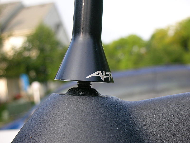

Hi All,
A few weeks ago I attended a MINI run and was given a flying ribbon to attach to my antenna. Problem is I had installed a 2 " shorty (this being my first run and not knowing I would be given a ribbon that attaches to the std antenna) and naturally the ribbon would not stay by me attaching it to the top. Therefore I had to unscrew my antenna to loop/attach the ribbon to fit in between the screw and base of antenna - basically the ribbon was hanging in between the screwed antenna base and antenna mount. (Actually, I could not get it to screw back into place so I had someone else do it.) Anyway, ever since, I have not been able to get that flush fit with my shorty antenna and have instead resorted back to the std radio car antenna that came with my baby. When I try to screw in the stubby there is about a 3/4" gap in between the base of the stubby and the base mount. I thought that maybe there were some ribbon threads stuck down in the base of the antenna but yesterday I finally stood on a chair to look inside and didn't see any leftover ribbon threads. I have no idea what could have caused this. Btw, I have the alta 2" stubby. Please help!

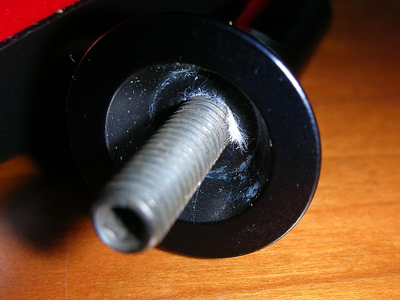

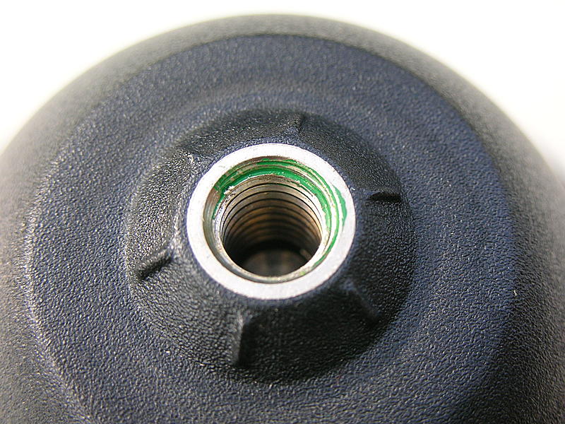

Robin - I just tried that and the screw seems tight in the antenna....any other suggestions? Also, I am posting some pics to to show exactly what I mean. The screw antenaa does small piece of thread but I can not imagine this being the issue (especially since it is deep into the top of the antenna and this no where equals the amount of gapped space).

Weird, huh?? Well if the antenna is okay then maybe a threaded insert in the base has backed out? Seems like it has to be one of the two since it was in there correctly once upon a time.

My guess is when you removed the stubby you managed to back the mounting stud a turn or two out of the antenna. Looking at the pics you posted I see that the mounting stud appears to have a hex socket end.... I'd try turning the mounting stud back into the antenna..... This will shorted the exposed part of the stud an allow a flush fit.
Get the right size hex key - stick the antenna on it and try to turn the antenna farther down the stud.....

Hey guys. You are on the right track. Take a allen wrench and remove the stud from the base of the mast. Then screw it into the base on the car. Then put the mast back on. Should be just fine. If not let us know!
