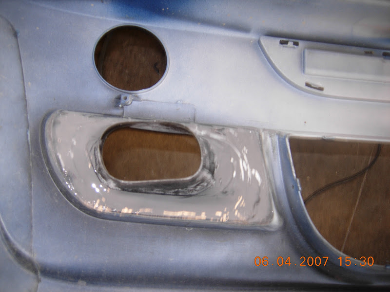

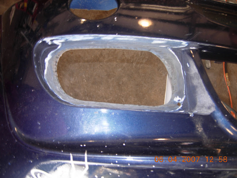

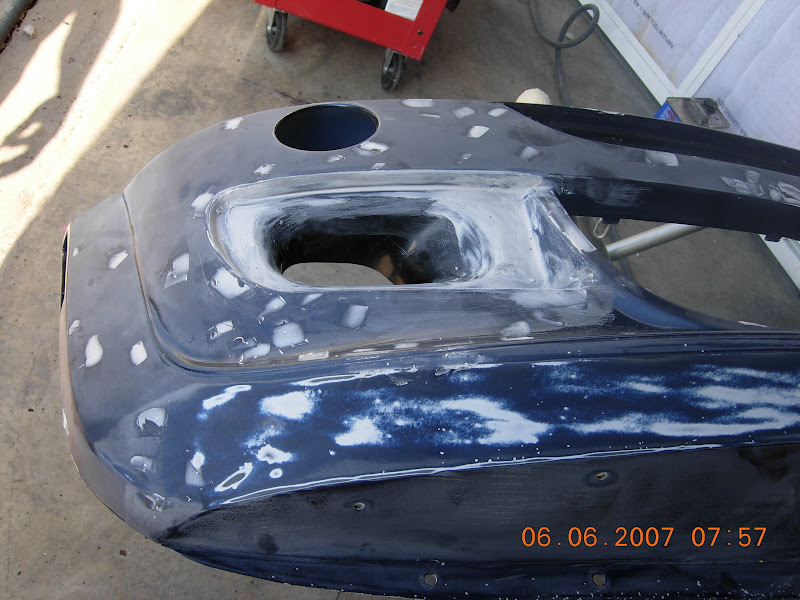

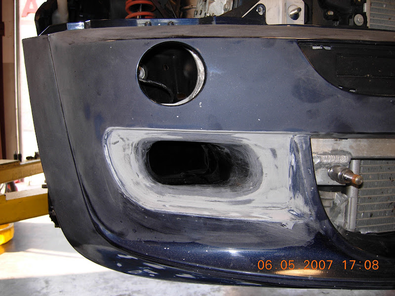

Opening for Brake Duct. Keep in mind the brake ducts from Way Motors are designed for the standard front bumper cover. I have the Aero Kit.
Duct Fitted to opening

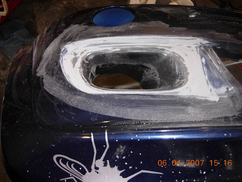

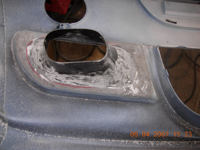

Pop riveted in place and filled with a 3M flexible adhesive

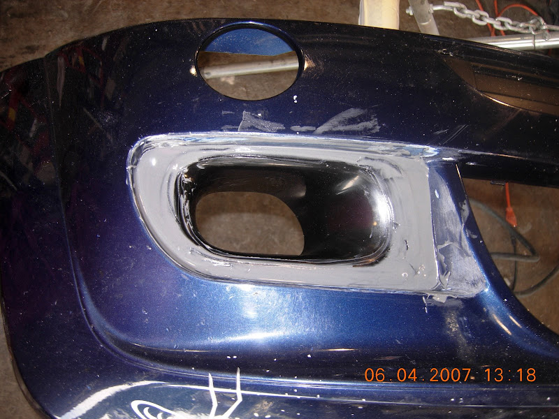

After a second coating of the 3M adhesive material and sanding, lots of sanding

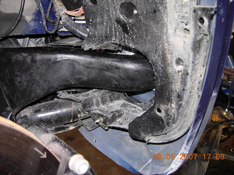

View from the back
A coating of the 3M adhesive
After the adhesive has set overnight to fully cure the plan is to come back and add a few layers of fiberglass cloth using the 3M product as resin. This should strengthen the area yet allow it to give some. Then it's off to paint.

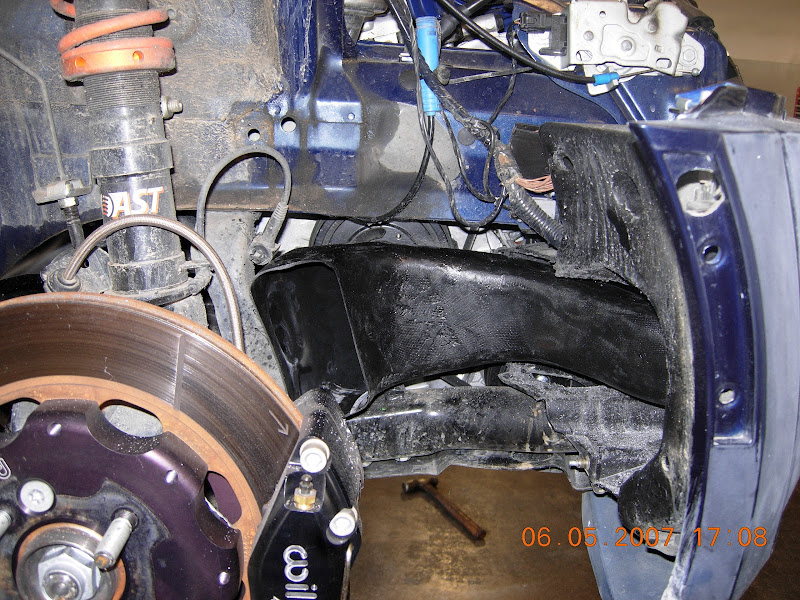

Over the past few days there has been a considerable amount of work.

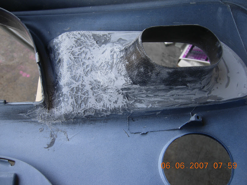

Ducts from the rear, fully glassed in now.
Fixing all the little rock chips.
When I stopped in late today the bumper cover had a new coat of primer on it and was being sanded to remove the imperfections.

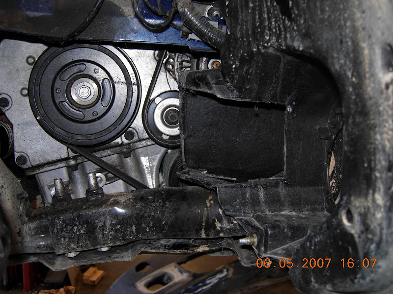

Fitted on Mini to measure where to trim.
A little trimming
Makes room for this...
Sure do have to remove a bit of plastic...

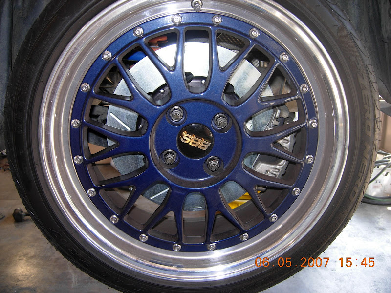

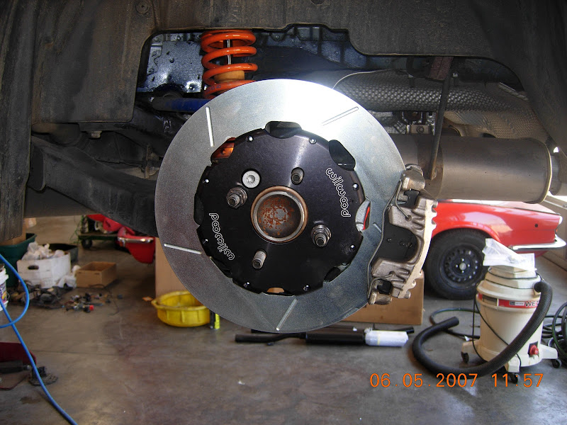

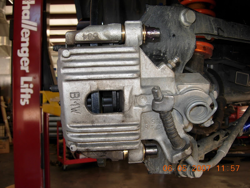

A little more rotor in the rear...
Fills the wheel better
Why yes...of course we added uprated bushings and SS lines while back there

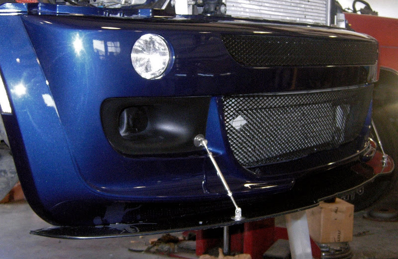

Here is a much better shot, shows how it all comes together. The ducts, the cowl scoops and Kraft mirrors. Thanks to dickdavid for the image taken today at the MetroplexMini monthly meeting.
