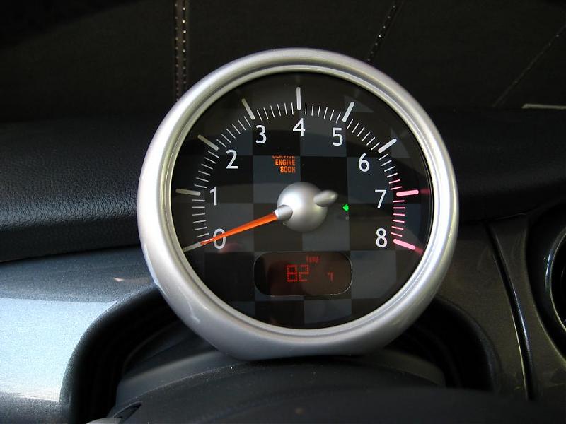

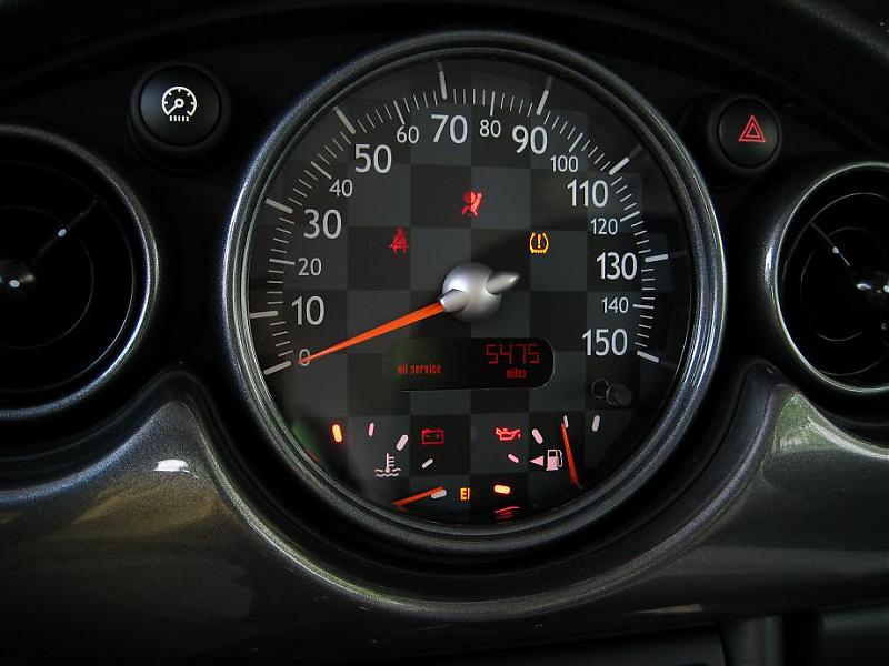

I'm going to attempt to upload these pics I just took of my new checkerboard guage faces. They were easy to install thanks to the how-to thread here at NAM. The job took me about an hour and a half. The hardest part for me was lining up the needles. These two pics are of the speedo.
Hopefully more to come.

Here are two more pics of the tach. Special thanks to ImagoX for the how-to thread!

Those look really sharp! Not too busy at all and they look great against your interior. Glad the How-to helped!

I like the design and look of the gauges but i dont like the way the warning lights are varied brightness, like where a light crosses a grey and a black square it looks different brightness, and that kinda looks cheap that they couldnt make it unified.

I think they look great. And, importantly, not so busy that they are difficult to read.

I agree on both points. They look great and much more readable than I expected for having a pattern on the gauge face. However the warning lights do look odd.

That is my only complaint - well not really a complaint. The warning lights don't pop-out at you like they do on the OEM face. I have the gray/black UJ and the warning lights are far less visible, however the new faces look too good to quibble about trivial details. What are the chances of a MINI's warning lights going off.

agreed, and the cut outs for the ovalish displays, there appears to be a white edge, like a stamped out piece of paper or cardboard puzzle cut out piece. Maybe it is just the flash catching it, but if it is white, that would bother me. I know how hard it is to capture true interior details, so it might just be camera type issues.

On another note, I noticed that for the tach, when I turned on the headlights it lit up well EXCEPT the area around the number "6" (about 1 oClock on the dial). I reopened my tach and carefully removed the tach face and found the reason this area wasn't getting lit was because the area around the number 6 was obscured from receiving light by part of the white plastic frame behind the guage face. I resolved this by and cutting and removing this inner area of plastic with a wire cutter. The tach dial now lights up fine.

Yeah I have a little spot around 8 on the tach (I think it's 8...too lazy to go look right now) that doesn't light up quite right. But it's not bothering me too much so I'll get to it one of these days.
