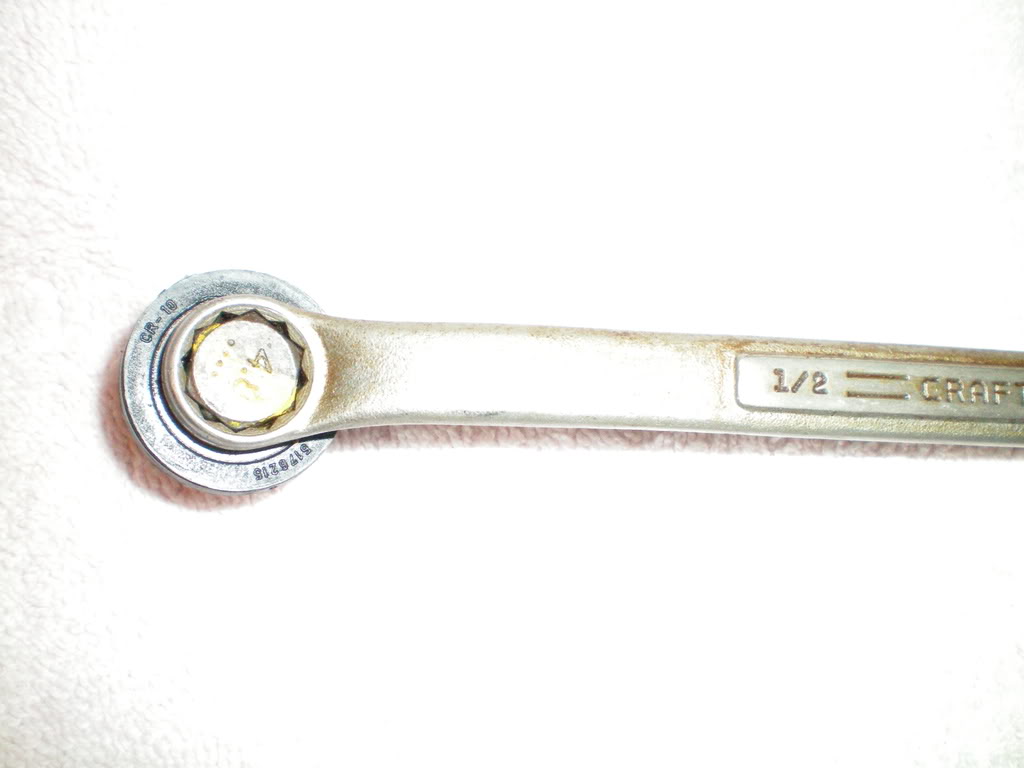

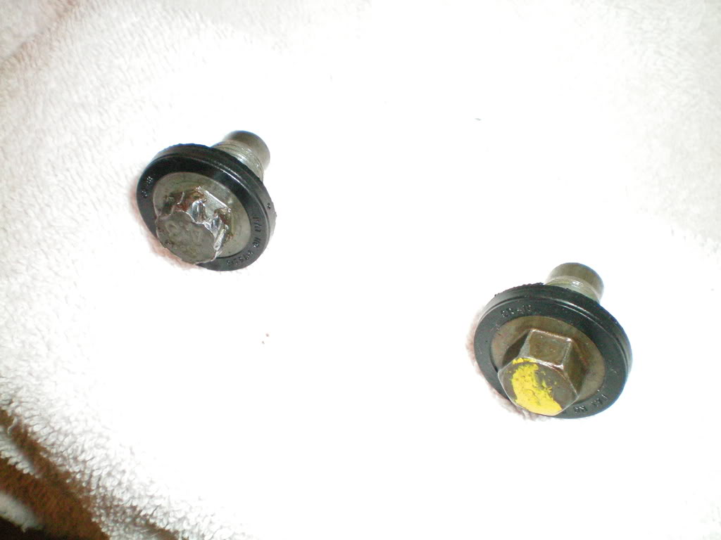

Old Mar 3, 2013 | 12:27 PM
  #283
Capt_bj's Avatar
Capt_bj
Posts: 7,037
Likes: 283
From: Melbourne, FL
the books say 13mm
do the math ... 1/2 inch is a wee bit smaller then 13mm and guess what? Fits PERFECTLY so you get a better grip on the bugger
I've not torn up a 'stuck' one since I discovered this . . . mangled a couple b4 then tho (12 point wrench for illustration purposes only ... but with a 1/2 you'll get away with more often then you will with a 13mm!)
with that very 12 pt 1/2 inch wrench I've been able to use a leg to apply force to a stuck one successfully getting it loose with no damage to plug or pan!
