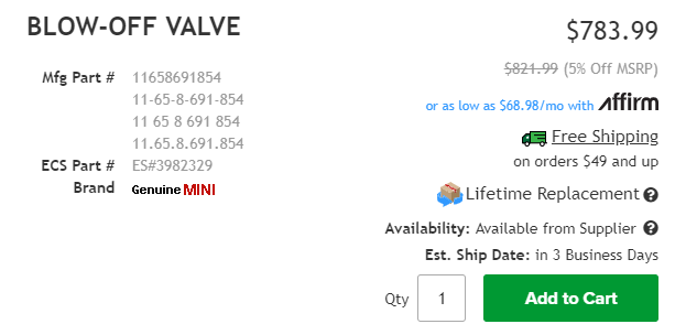

I couldn't find any hits from the numbers on the part in the picture, but 11658691854 seems to be the one? I can't find any google image hits but it's the only one I can find.
It gets a little complicated because a lot of the F56 gen cars don't have a DV at all, the F56 GP3 doesn't seem to be on RealOEM, and I couldn't find this under a few years of JCW F54/60.
Eventually I found it under the end of production F56 JCW, listed with B46D engine.
RealOEM shows a bunch of applications if anyone is looking for one from a junkyard.
If someone happens to come across one, it would be nice to have confirmation.
I also think the connector PN is 7615487
If you google that, it should give some options for straight replacement housing/pins/seals or flying lead options.
Last edited by Northern; Apr 3, 2024 at 11:25 AM. Reason: Copied pn from wrong tab lol
Old Apr 3, 2024 | 10:42 AM
Posts: 36,758
Likes: 2,548
Yep its on those new turbos for the 300HP+ Most New MINIs dont have them, it looks like MINI just did it on the high HP MINIs and shared BMW engines.
I have already contacted Pierburg that makes the OEM part. They said maybe soon it will be released into aftermarket.
Genuine MINI part:
https://www.ecstuning.com/Search/Sit...h/11658691854/
https://www.realoem.com/bmw/enUS/sho...diagId=11_8083

I think I literally fell out of my chair!
Old Apr 3, 2024 | 12:16 PM
Yoshimura 1's Avatar
Yoshimura 1
Joined: May 2018
Posts: 1,055
Likes: 73
That's really insane.........
Old Apr 3, 2024 | 12:23 PM
Posts: 36,758
Likes: 2,548
Yep, welcome to MINI $$$
This is what they price things at when they first come out, down the road the price may go down. I have seen some MINI parts that cost more then the compatible Rolls Royce part.
