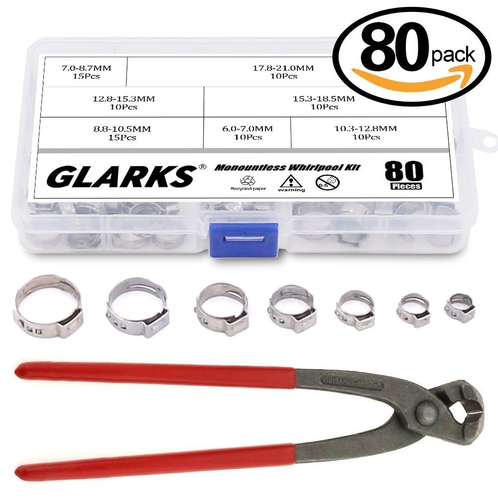

I dont have the Ear clamp pliers, or three-ended spring type hose clamp tool either (Gunna have to look that one up!). Do we typically reuse the ear clamps?

The water hose clamps are the three ended type. You can use a pliers to get them off but with a regular pliers they will spin on you if you lose grip and then its a PIA to get to them. The air hoses are the ear clamps. If you can get to them, a screw driver will pop them and then a normal pliers can get them back snapped. I changed the ones I have on the BPV and TB to worm drive.

How about:
Amazon Amazon
and
Amazon Amazon
and
Amazon Amazon
Attached Thumbnails e-sockets - what range do I need?-61kly2toizl._sl1000_.jpg   e-sockets - what range do I need?-81m2xiajddl._sl1500_.jpg   e-sockets - what range do I need?-61ntrmoykgl._sl1500_.jpg
