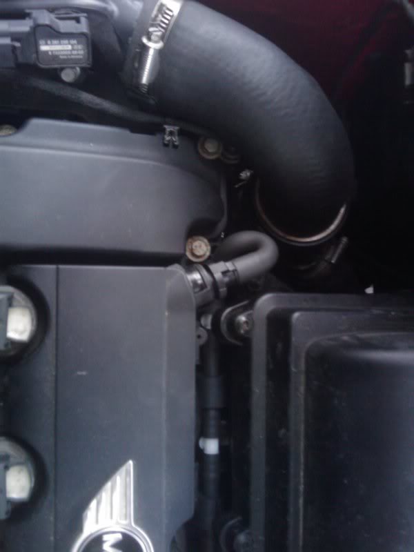

Sorry for being a noob, but I'm not sure which hose it is. I pulled off the one here and it smelled like gas and had some nasty looking stuff pouring out of it. I don't see where it goes to the other side of the engine like in the diagram. The length of it sits on the top of the engine behind the cover. The one in the video and the one in the diagram look a lot thicker than this one.

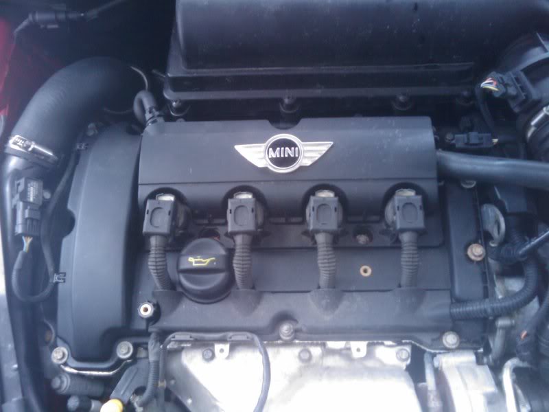

Here is my engine bay. Can anybody point me in the right direction?

Well I did it in that hose and it seemed to work. Smoke POURED out of the exhaust already!! Waiting about a half hour before starting her up again.

Its on the top left side of the block. It's a small hose, much smaller than the one in the video. I used some tubing from fish tank supplies and let the car suck it out of the can. I'll try and make a vid tonight for us R56 people that don't know this car very well yet! Haha!

Im planning on doing this today. I just want to make sure I am putting it in the right spot. Here is a copied pic of an R56S engine bay. Is the red arrow were the seafoam goes in?
Old Feb 6, 2010 | 07:37 AM
  #173
Oxybluecoop's Avatar
Oxybluecoop
iTrader: (-1)
Joined: Oct 2007
Posts: 2,977
From: Delaware
Yes that's the correct hose.
