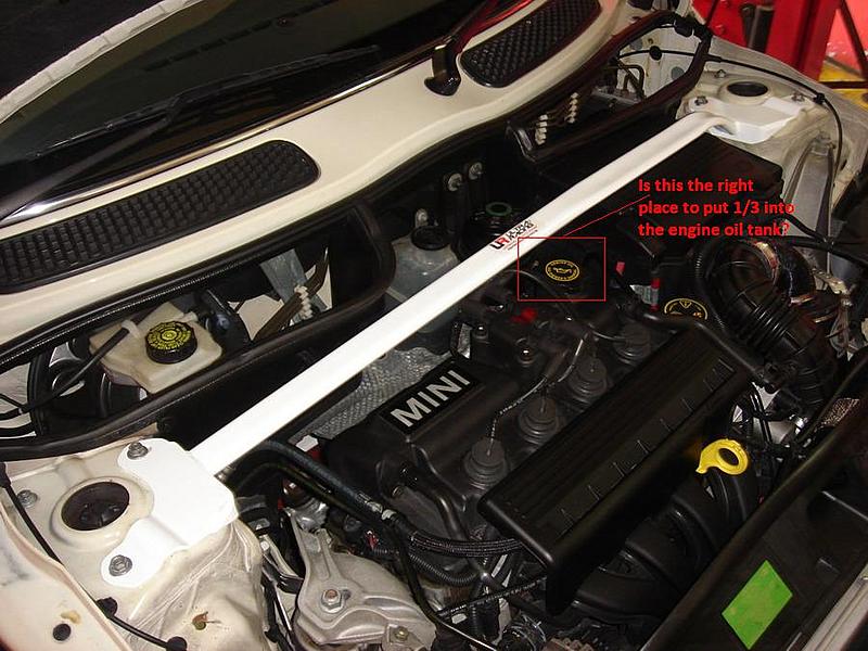

Hi all,
Finally I managed to buy Seafoam from the internet. Just got few question to confirm before I do it on my 2004 MINI ONE (just to make sure I didn't screwed up).
1. Put 1/3 into the petrol tank, the petrol tank should be full or half or .. ?
2. Put 1/3 into engine oil tank, right (pls refer to the photo just to make sure I put it in to the correct place)?
3. Put 1/3 into the PCV hose? <-- sorry I not sure where is it located in my car, pls help pin point thru the photo
Thanks alot, can't wait to seafoam my car
Attached Thumbnails Maintenance :: How-To do Seafoam Treatment R55/R56-2_engine_oil_tank.jpg   Maintenance :: How-To do Seafoam Treatment R55/R56-3_pcv.jpg

Theres really no need to put it in the oil.
You can put it in the 'petrol' tank if you want. But the best is just running it through the PCV, which in your picture is B.
