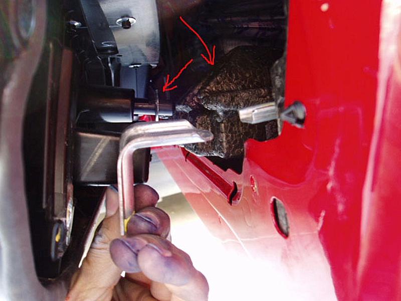

7. remove the two round rubber plugs from the bottom side of the door:various 043.jpg
8. shine a flashlignt into the hole from which you removed the rubber plug and you will see a screw that goes into hole of the bracket in the image. unscrew this screw and then unscrew the other one :various 037.jpg
9. now you should be able to gently pry the bottom of the door panel away from the bottom of the door. at a certian point you will feel some resistance. this is due to a screw that goes through a piece of black styro-foam at the bottom of the door. this screw is held in place by a washer on the other side of the foam. you must pull the washer through the foam. this will effectivley destroy the function of the washer but it can be fixed later durring installation with some silicone sealant. the image shows the foam, screw and washer, as well as the bracket that is attached to the door panel that is screwed to the bracket that is attached to the door mini black foam.jpg

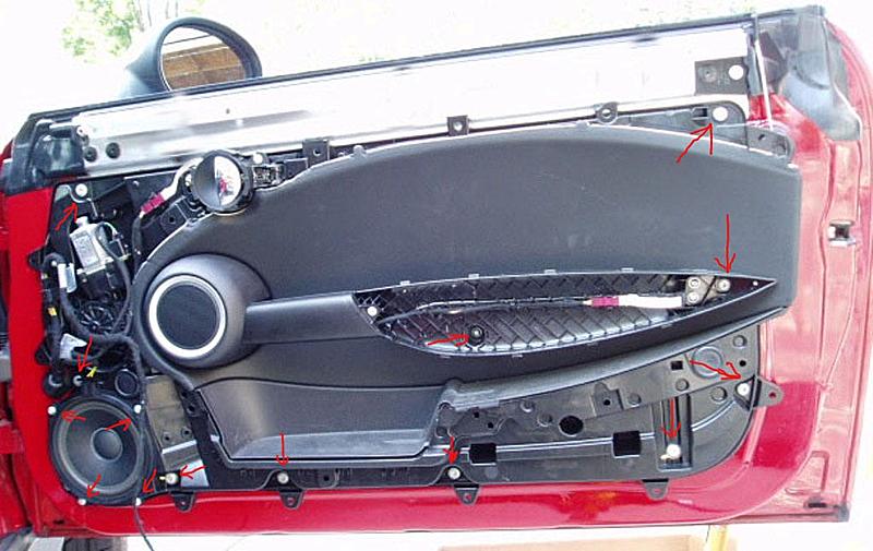

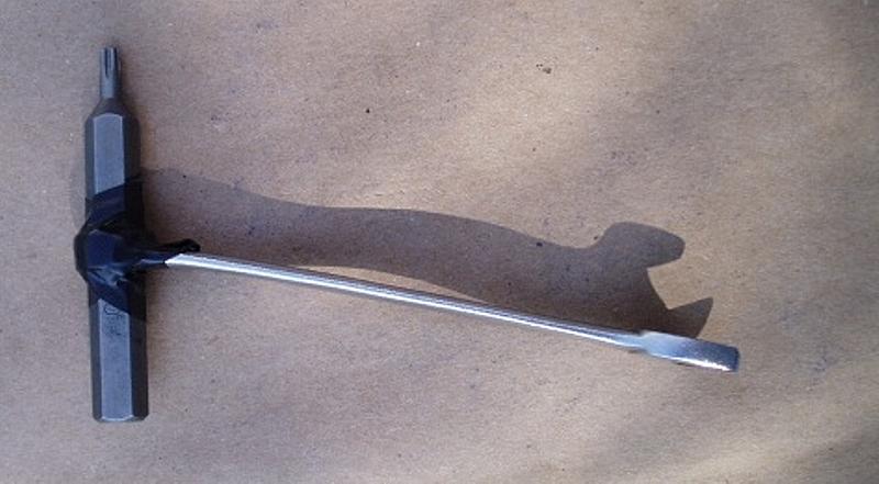

10. you will need a torx wrench to unscrew the three screws (see third image, two of the screws are circled in green) that hold the top side of the door panel onto the door. my torx set was purchased at Pep Boys Automotive. i used a standard box end wrench to turn the torx bit and used some electrical tape to keep the bit from sliding up and down in the wrench. you could also use a 1/4" rachet and torx bit if you have one (would be easier than my setup). in order to get at the screws, you will need to lie on your back on the ground. slide your hand up between the bottom of the door panel and the door, extend your arm and use your finger tips to feel around for the head of the torx screw in the locations indicated by the red arrows in the image. unscrew the three screws. if you are a big person, get a skinny friend with long arms and small hands to do this for you. installation is the reverse of removal. happy trails various 034.jpg

I'm trying to get this internal door panel off so I can get my door lock rod back in its clip (when I pulled off the outer door trim, the door lock was up, and it seems I pulled the door lock rod out of it's clip).
So, I'm having trouble reaching up the door to get to the three screws in step 10. Is there any way to remove the aluminum plate instead from the door such that door panel stays attached to the three screws and the two pieces move together?
All I'm trying to do is gain access to door lock side so I can see what I am doing to get the door lock rod back in place.
Argh!!!

3 Screws
You have my sympathy. I recently did a sound proofing project (CANNOT SAY ENOUGH GOOD THINGS ABOUT ANTHONY @ SECOND SKIN AUDIO. PRODUCTS AND SERVICE WHERE UNBELIEVABLE!).
It took my dad and I about 1.5 hrs to wrestle them out. There is no trick, just patience, grasshopper. Needless to say, after installation of the Damplifier to the door sheet metal we ditched the three screws upon re-installation and simply used one central, short sheetmetal screw to secure the top edge.
You could try removing the window and support beam as a unit/sub-assembly...you will need an extra set of hands or two. Good luck!

Ok, after discussing with car buddy at work, I plan to leave glass in place.
I will find where blind screws come into inner door molding (I think it's obvious from the little bumps in the inner door panel) and will "drill out" the screws such that I can just pull the panel off (either a drill slightly larger than the screws or a hole saw just a little bigger than the screws).
Then I will take the screws out of the aluminum cross piece, drill the holes out a little so that I put pem nuts in, then I will use a screw with an appropriate shoulder or a screw and washer to attach the panel from the front side into the pem nuts.
Of course this is all predicated by the location of the three blind screws being covered by the outer door panel...
