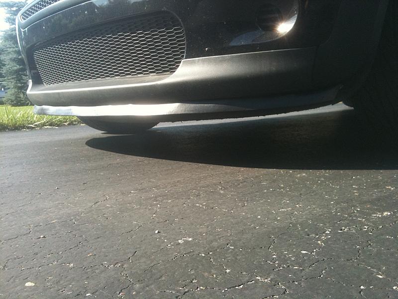

Did mine 2 days ago. I decided to cut the ends flush with the stock break in the bumper.

  #231
First picture was when i used big washers, notice the bulges coming out, so went back and used smaller diameter washers, looks great now.
I did this about 2 weeks ago, sorry about the dirty filthy car. I SWEAR ITS NEVER LIKE THIS!!! So because of the dirty car and just putting black wow on the splitter quick, it looks kinda bad. oh well!
DIY: Home Depot front lip-picture-219.jpg   DIY: Home Depot front lip-picture-218.jpg   DIY: Home Depot front lip-picture-217.jpg
