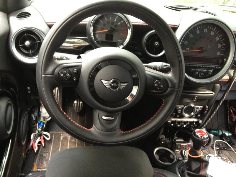

Installed my MFSW retrofit in #0425 today. Picked up a leather JCW wheel on ebay w/ switches ($250) (planned on a wheel swap anyway - not into the extra thick padding on the GP wheel), and a blinker/wiper switch from a countryman (SZL part #61313453991, $165).
Simple swap - fought my ICAN cable though with random errors when it was getting hot, but the next day everything went ok.
Just doing a SG_RESET on the SZL wasn't enough to get everything working - had to add $249 (MFSW) to the VO, FA_WRITE the VO to CAS and FRM, then ended up doing a SG_RESET on everything - remember it's not just the SZL, since the rest of the car needs to know that cruise should work...
So 425 now has cruise! And steering wheel control for the stereo! And a decent steering wheel.
btw - pulled both the new (used) and the GP's SZL apart - and sure enough, the header between the clockspring and the circuit board that the MFSW switches should connect to the board through is missing. If one really wanted to keep the stock switch, you might be able to add a header for it...certainly the module will accept a MFL aktiv, so the rest of the electronics might be there. Or just switch the physical wiper stalk over. If I dont do a rear wiper retrofit, I might do swap the stalk.......
And no, I didn't get pictures of the missing header. Sigh. It's sitting on the shelf, so I could if someone needs it...
